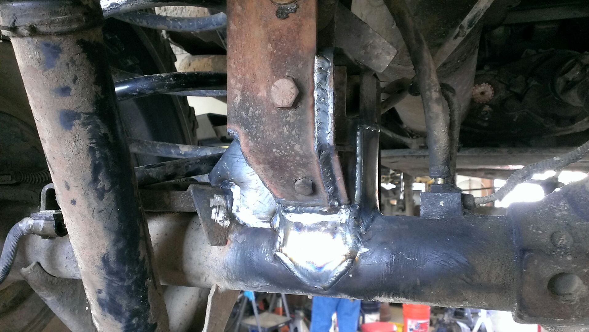

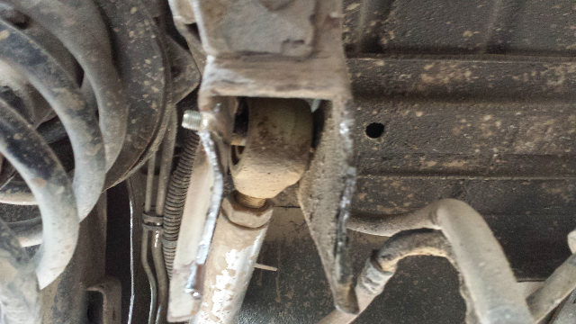

Did the local crown king run with my local group. 147 jeeps on the run this year. Multible flops, broken parts and other break downs. My jeep included not sure when but broke the welds holding the rear track bar/ upper control arm off this weekend.
Looks like going to have to take it to the shop for some welding and gusseting.

We left in groups starting at 5AM and one every hour till noon. I tail gunned the 10AM group. Well got the track bar/ upper control arm mount re-attached to the axle. 100$ wasn't so bad on what he did. He plated the sides and added a tail and tongue on both the front and back to keep this from ever happening again.
