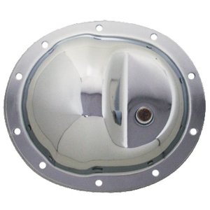

D35 has an oval cover.
8.25 http://stores.hi-potek.com/catalog/P4130063(2).jpg (this one has a drain plug addded)
Your ZJ doesn't have an 8.25, wasn't an option. You either have a D35 or D44a, not to be confused with a D44. Some have an aluminum center section, c-clipped axles and almost no aftermarket support.
