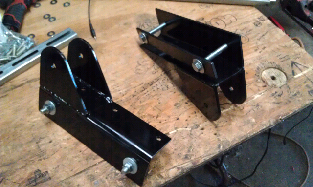

Got the lower frame mounts finished and painted today
