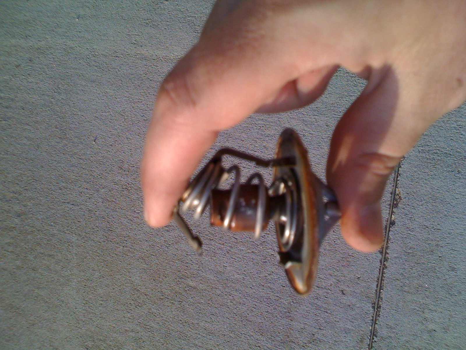

The thermostat wasn't just stuck open...it was BROKEN. Very close to shooting metal parts into the engine block. (See photo below.)
Since I was in there, did a flush and fill...the coolant was red, which in my mind means there's rust in the system somewhere. Gotta get that stopped.

At some point Chrysler switched to "HOAT" antifreeze which is an orangy-red color. "They" say NOT to switch to any other type of antifreeze. My 2005 has "HOAT" - maybe 2003 was "HOAT" too and that's why it looks rusty. Mikey may chime in and tell us when the change was instituted. - John
I had a T stat self destruct like that in an old Chrysler 440. The part that held the pellet broke off so it had nothing to push against and the stat stayed closed.
