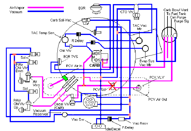

Ok so I just rebuilt my POS Carter 2 bbl and went to hook up vaccuum again and have a port on the back of my carb right below the stepper motor that is open and I cant figure out what goes there?

However I still cant figure out where that port on the back of the carb right below the stepper motor is supposed to go to...anyone?

As the diagram above shows (which is mind numbing to look at), You should have one port going to the PCV tee'd off to the decel valve and upstream AIR tube. The other one should go under the air cleaner to the TAC sender and vac chamber.

Ok I am thankfull for everyones input but as I stated I have three manifold ports not just two.
