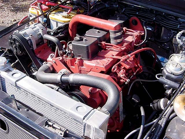

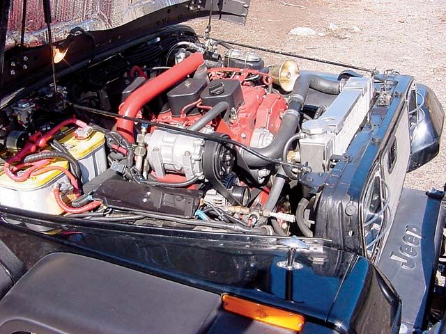

Here's some pictures, (had to steal them from another site). :piratenanner:
whoops...

The pics you posted look very similar to my TJ. Where did you find them.
