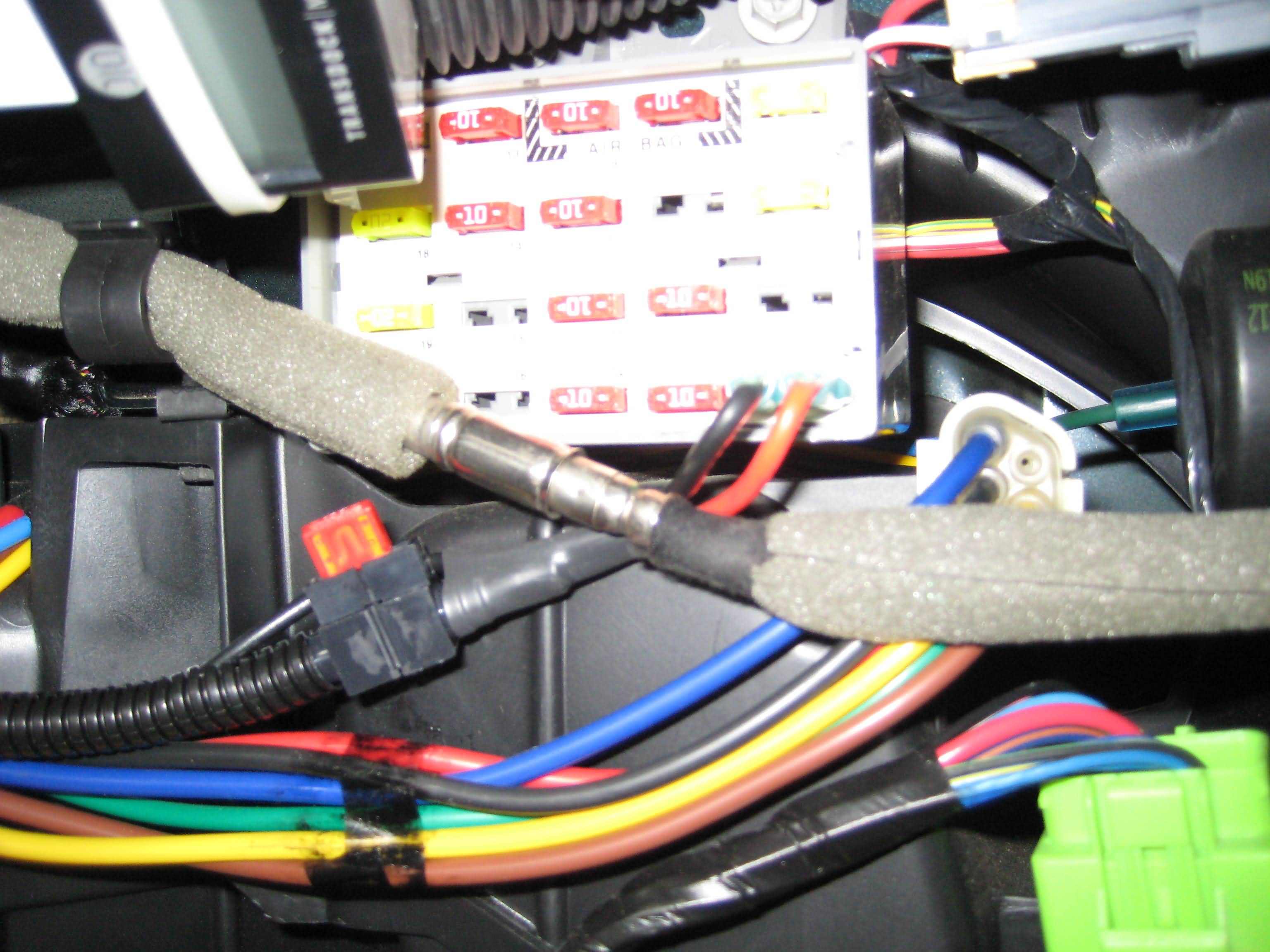

For turning off the lights this thing is the bomb:
http://www.jeepz.com/forum/product-reviews/22322-wrangler-dome-light-switch.html
<img src="http://www.jeepz.com/forum/attachment.php?attachmentid=17003"/>
It essentially puts a switch inline with the fuse. It's pretty hard to pull that fuse with your hand, and the springs that attach to the door seem to pop off (or I close the door on them...).
That fuse the switch takes the place of is the one that also goes to the headlight chime. I ran my battery down twice this summer already because the chime didn't sound.
Just an FYI
