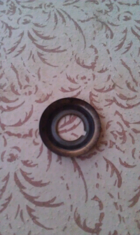

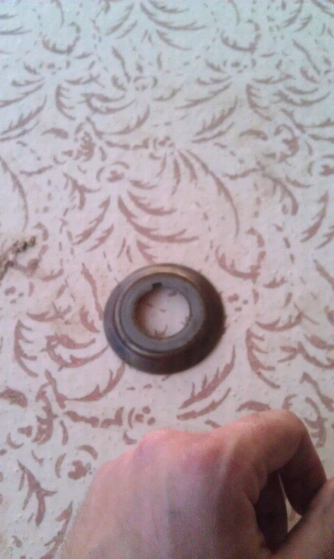

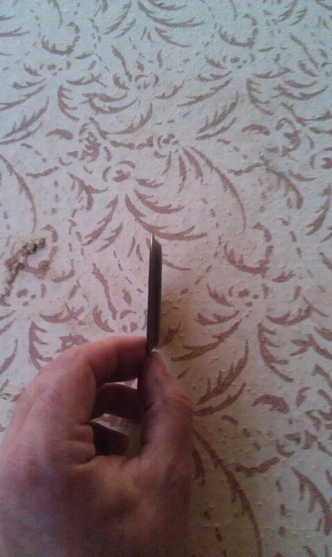

I have a 97 jeep tj 2.5. This object was sitting in front of my crankshaft gear on the timing chain just before the cover. My question is, is it important, does it need to be there?
it looks like an oil slinger. usually, those are put in front a place where oil might leak out while driving and the oil hits that and then is slung away from the area being protected.
No i placed it back in. But I'm trying to locate a horrific noise and I thought it might be that

That looks like the seal that was on my timing chain cover. It gos on the circular opening of the timing chain cover. That notch go,s over a keyway.
did you put it on the same way it came off?
sometimes people put those back in backwards and they dig a groove into the covers making a terrible noise. or they put a washer or spacer on the wrong side of it doing the same thing

Yes I placed back in the right way. But it wasn't causing the noise so I took the cover and everything off for nothing. So I'm back to square one
