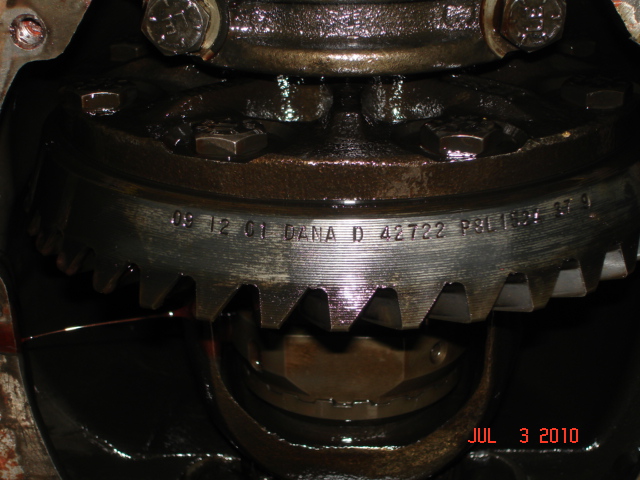

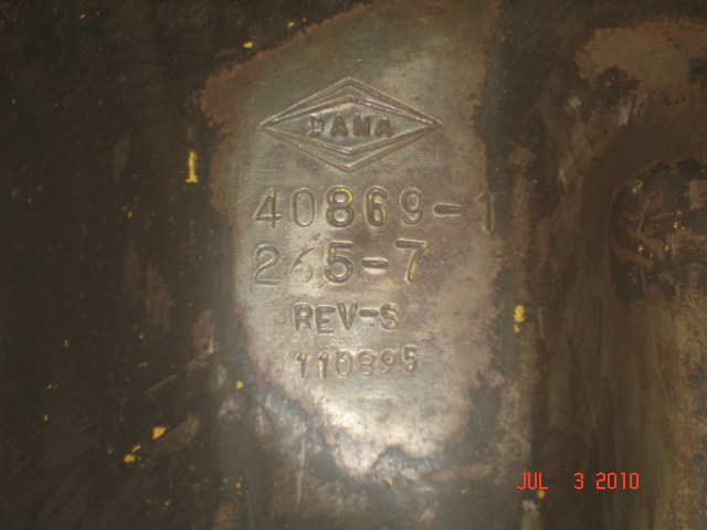

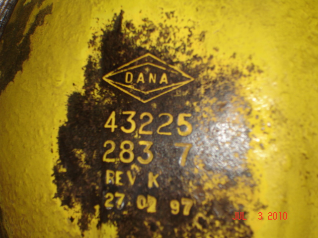

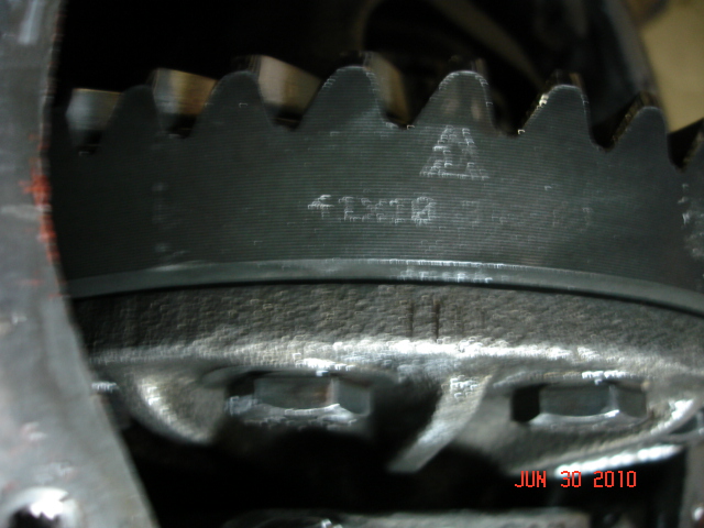

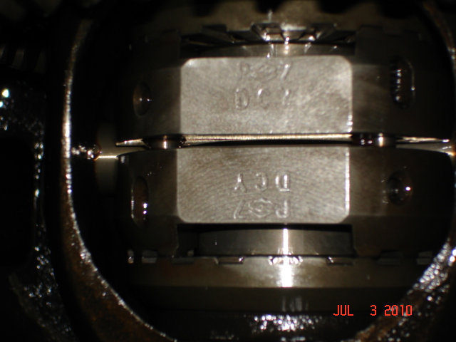

I've been changing lube in the TJ axles and took pics of the gears and lockers
Can anyone tell me what the brand these lockers are and what the numbers represent on the gears
When I bought it last year the guy told me it had EZ Lockers and 4.88 gears,Dana 30 in front and 35 in rear

Top gears look like 4.11 (37 ring teeth/9 pinion) and the second set are 4.10 (41 ring/10 pinion).... the others look like the diff covers.... there should be a number on the axle tubes which will give you more info about the axle than the cover....
Yes your right wrangler76 had a gear guru over the other night he agreed
Wasn't quite sure if they were Lock right or easy lockers
as long as they keep workin its all good
