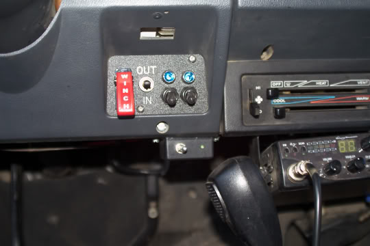

I recently put a new switch set for the winch controls inside the cab.
If someone had been outside the cab watching the rope as it pulled, the rope situation would (possibly) not have happened. But, as the Winch does represent a heavy battery usage (and you may need to keep a foot on the skinny pedal), who knows...
