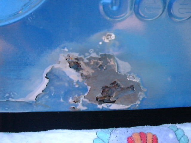

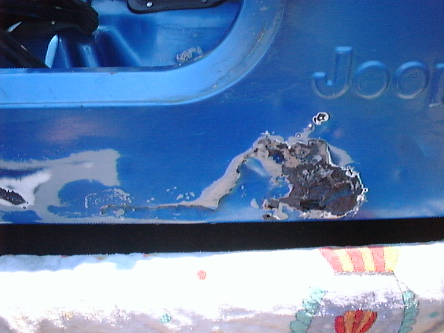

Step 1 - knock down the large pieces
Here's where we start, with a well rusted side panel on my Jeep. Step one of the clean up is to knock out all big rust pieces with a hammer

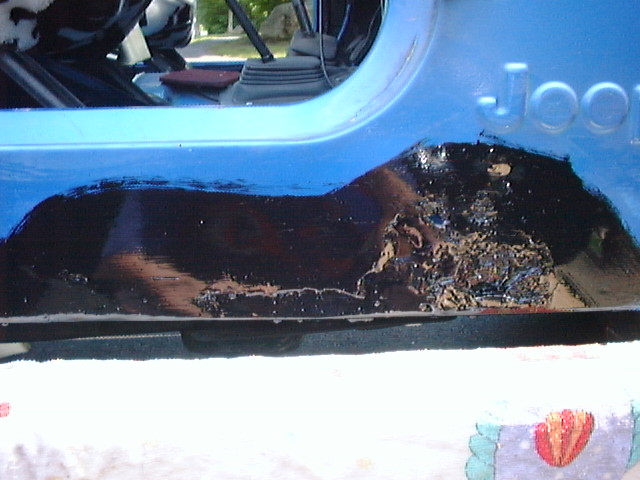

Step 3 - prevent more rust
Now that the rust is out, coat the area with a rust preventative, I prefer POR 15.

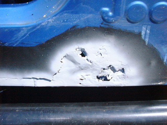

Step 4 - Prime
Spray the area with some rust proof primer, to give the body filler something to stick to.

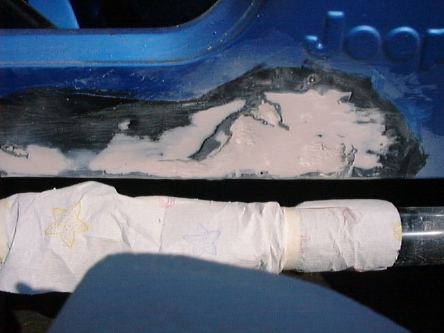

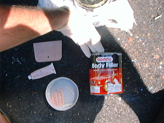

Step 5 - first round of bondo
Get some body filler, my favorite is Bondo. It's also a good idea to wear some rubber gloves, it makes cleanup a lot easier.

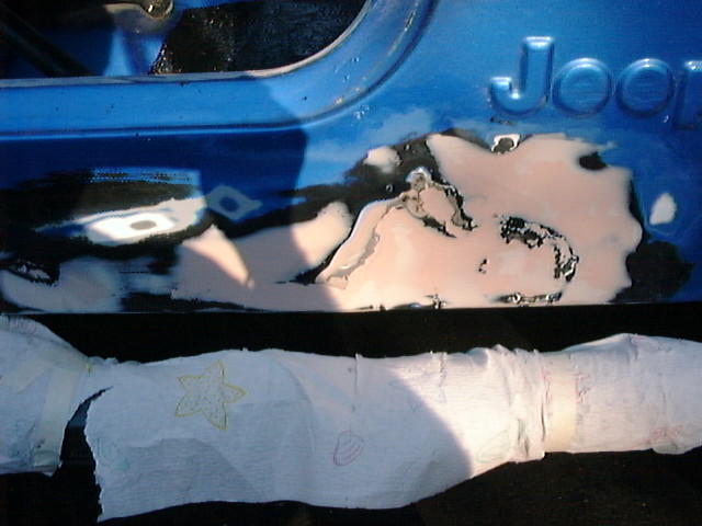

Put on the first coat of body filler, just spread it out as good as you can, this layer doesn't have to be perfect. Make sure to let it dry thoroughly.
Sand down the first layer of body filler, make sure there are no points sticking out farther than they should.

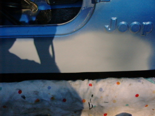

Step 6 - second round of bondo
Put on the second (and final if you're good) coat, and sand it down again
Sand everything down perfectly, and clean everything up. I used a rag and water to clean it

Step 7 - Prime the paint
Spray with several coats of good primer, and give it the final sanding with some really fine grit sand paper

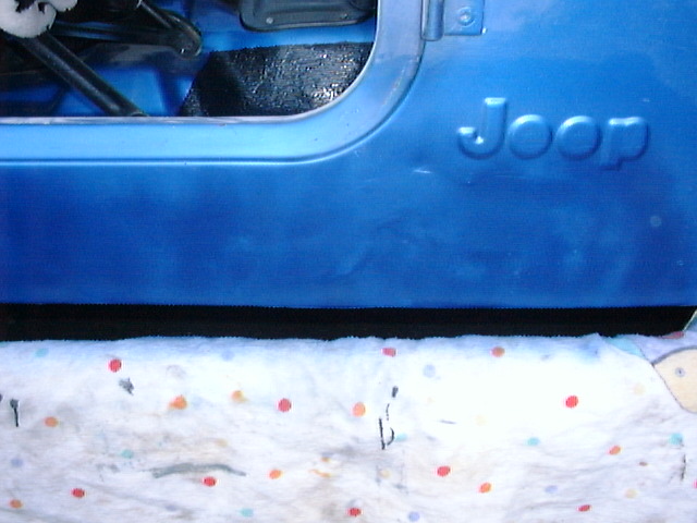

Step 8 - paint
Give it several coats of the final color and your done. I chose rattle can blue.
