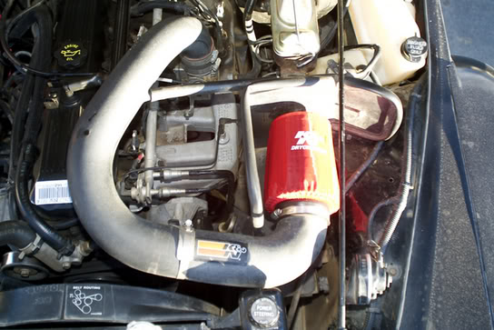

here is my snorkle i made from a sonoma k&n air filter system
I don't see an airflow problem with that. It looks fine to me in that area. What I wonder is how you plan to keep water out of the cone filter, I mean if you drive it in the rain like that you'll be sucking in rain water. Same would be the case if you were splashing through puddles, a deep hole, or a creek or something. Kind of defeats the purpose. I have seen at least three setups like that now and have yet to see a solution to that.
Yep, all your gonna do is suck up the rain water and so forth, and its just going to ruin the filter. I bet its loud as hell as well. My friend and I were talking about this last night and he said he saw someone with their filter box and filter sitting right up aginst the hood and it hissed really loudly and sucked in lots of water.
