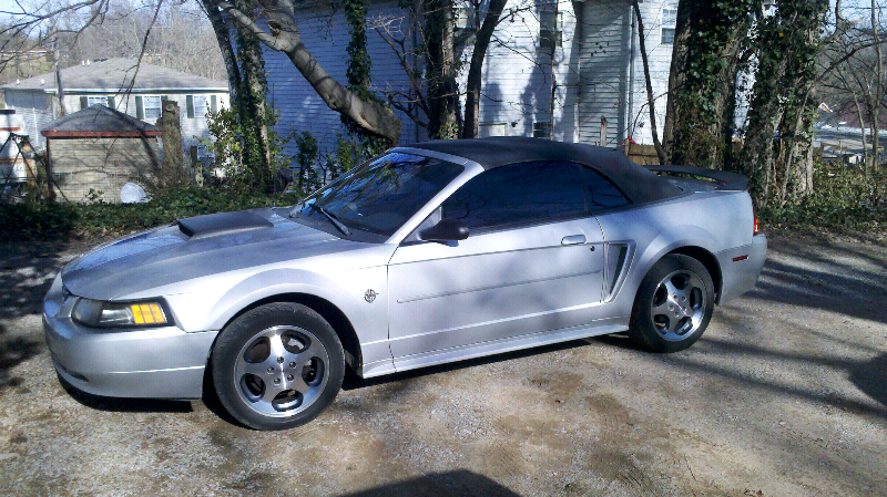

Ok so im back, iv been away from jeepz for a few weeks but i have a question and i dont know where else to post it. Iv searched and googled all i can so i rely on my jeep friends to maybe know, Ok so got a mustang last week, nothing fancy v6 automatic. 99 model. Its been driving fine until the other day i stopped at a redlight and when it turned green the rpms went up but the car barely, i mean barely moved. It revs all the way up to 4x and goes like 5 or 10 mph until all of a sudden it switches gears and its fine. All other gears seem ok, so my question to any auto trans guru that might be out there is. . . What the crap?! I found a used trans for $300 bucks but could it be an easier fix? Solenoid? Torque converter? Any help would be appreciative thanks in advance jeep friends.
