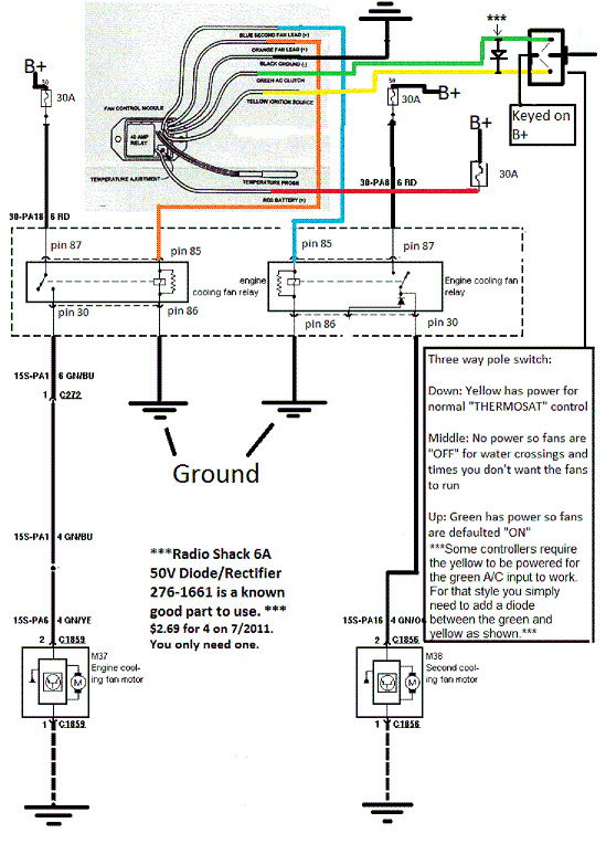

When I wired up my fans (Merc Mystique) I wired each fan independantly referring to this (and other) diagrams;
Testing with an override incorporated in this setup and they're working fine with 40 amp relays. Over the past year I've been review various diagrams and this one made the most sense to me. (A lift of the lynch lid to Mike Coiz for the diagram)
That's pretty much how mine is wired up; of course, now my DC Controller failed (for some reason it is not turning on), so I now have to replace it (already have the Flex-a-Lite one sitting in my garage for that purpose). Truly functional to wire it up like that.
The really nice thing about this 'roll your own' is if something goes haywire one will know where to look more easily and the componentry is affordable and normally locally acessible. I've seen other make this remark on the home built controls.

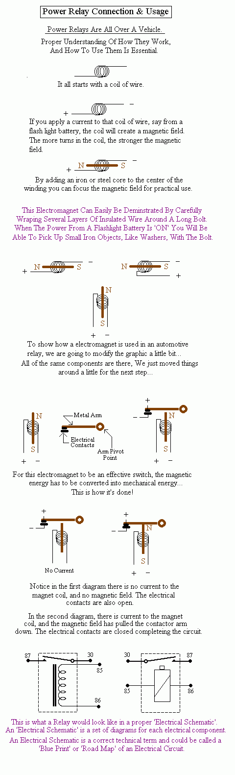

...and from the good book of JeepHammer;
RELAYS are used when you want to keep the wiring sizes reasonable.
There is no sense in running a highly loaded, 'HOT' 10 Ga. wire through the firewall,
Through a switch that isn't rated for anywhere near the amperage a 10 Ga. wire will conduct,
Then back out the firewall 'Hot' to what ever load might be on the other end.
When the switch is 'ON' the wire is hot both directions, and we all know what happens to wires stuck through holes in the fire wall...
Even if you use a 'Grommet' in the fire wall hole,
Eventually vibration and the weight of the wire will cut through the Grommet and then the wire insulation, and you have a MASSIVE short circuit!
(Excellent time to have a properly sized fuse or fusible link in the correct place!)
A RELAY lets you leave the Large Wires out in the engine bay,
Keep the short so they don't build a lot of resistance in the circuit,
And they keep you MUCH safer by NOT having them running in and out of the firewall,
Plus, a Relay can handle many times what a 'Switch' on the dash can, do it safely, and do it for YEARS without issues.
These quotes are from another forum but I'd rather not post link as I've been called on this before

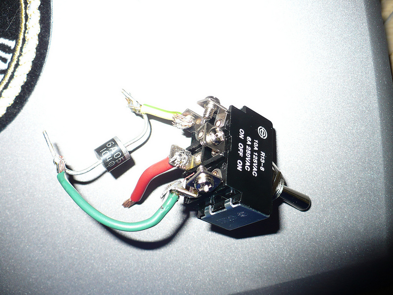

Actually 69jeepcj, you can use a double pole double throw switch (DPDT), to cut the clutter on the limited space we have on our dash panels. 8783388303_5ea2783816_c.jpg I got this one from Rat Shack and as I'm running the Merc Mystique/Ford Contour double fan setup the low speed is controlled by the resistor on the fan shroud itself. Therefore I wired each fan with the little controllers I got from NAPA 8672609847_2b5903c4c6_b.jpg and as far as the switch goes, one hot pole goes to this controller for thermostat control and the other pole of the switch is an Override On circuit. In this setup then while dual contollers and dual relays are being used only one DPDT switch is needed.
I hope this helps, initially I was mysitfied myslef by this fan upgrade.

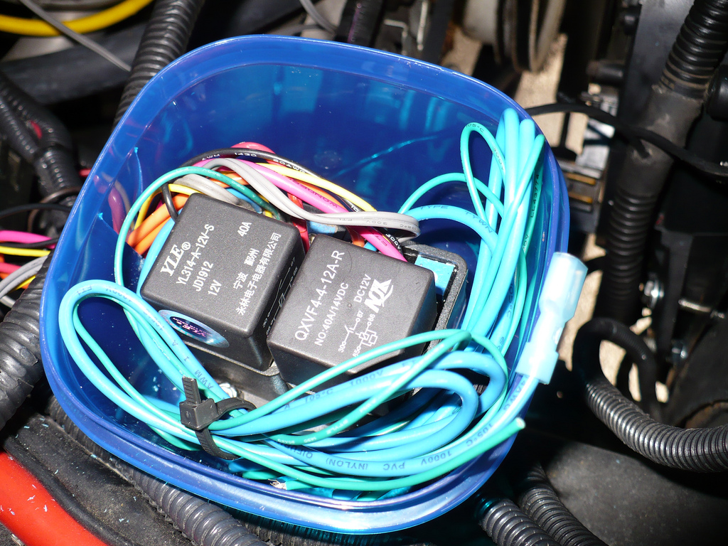

Thanks a lot guys, I went out last night and got a 40A relay to wire into the low side of the fan, (hopefully today). They didn't have any relays over 40A at that store, so I am going to keep looking for a 70A relay for the high side. I am going to look at the diagrams above to try and wire the 40A relay and just use the low side for now until I can get ahold of a 70A. Oh, and yeah I have the two speed, three wire ford Taurus single fan. Could I use the double throw pole switch posted above to run the low and high side of the fan instead of dual fans?? I have the three way switch now on-off-on, for high off low or should I just use two switches? thanks!
