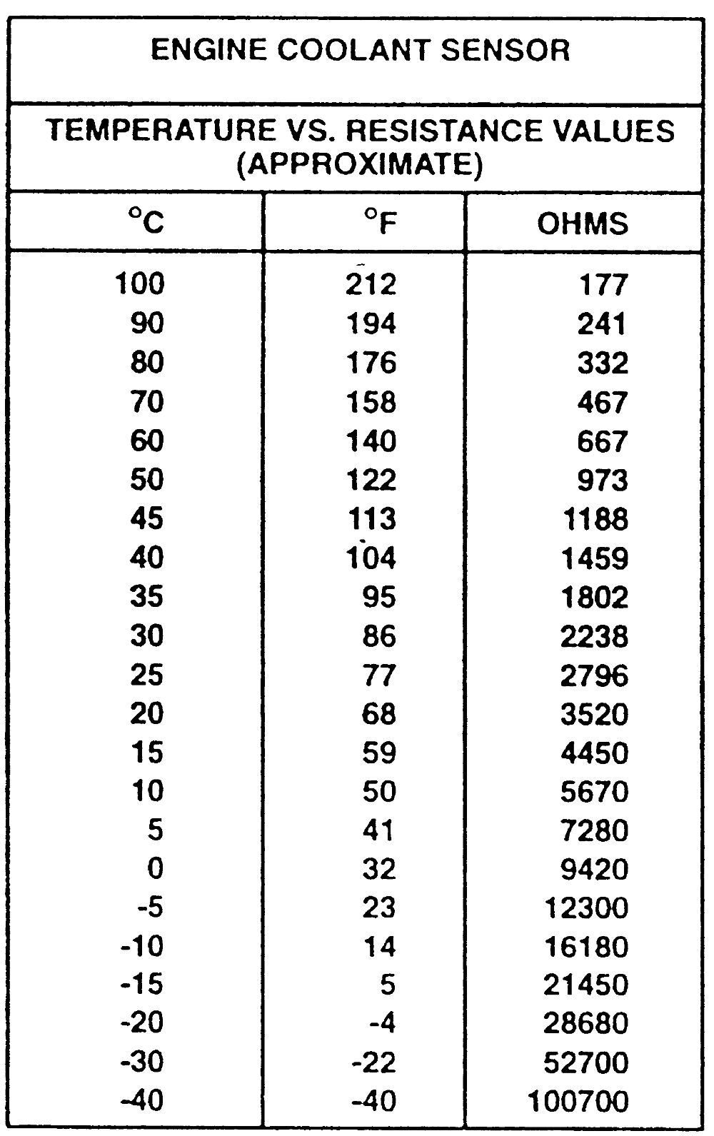

Yes check the sending unit. You could measure the resistance as the temp rises. I hope you didn't use anything or did use conductive anti seize as the threads of the sending unit are the ground path. I'll post resistance numbers if I could dig them up.

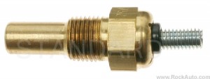

This is what a temp sending unit looks like for an 87 YJ. It has one pin so Teflon will likely cause an issue. Have you checked the gage cluster connector for rust or oxidation.
