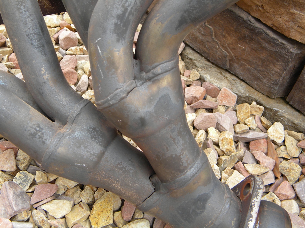

I to have the Borla and going through the warranty process right now. I have an 98 which is famous for cracking. Well after 2 OEM replacements, I bought a borla and got about 6 years out of it before it cracked. No other problems, but on the higher end of pricing. I figured with the million mile warranty, it would be my last header purchase.

wow you cracked your borla?? i have had my glowing red several times. and one time it was red hot when i dropped into a deep mud hole and submerged it in a mixture of ice water and mud.. no cracks no leaks so far
