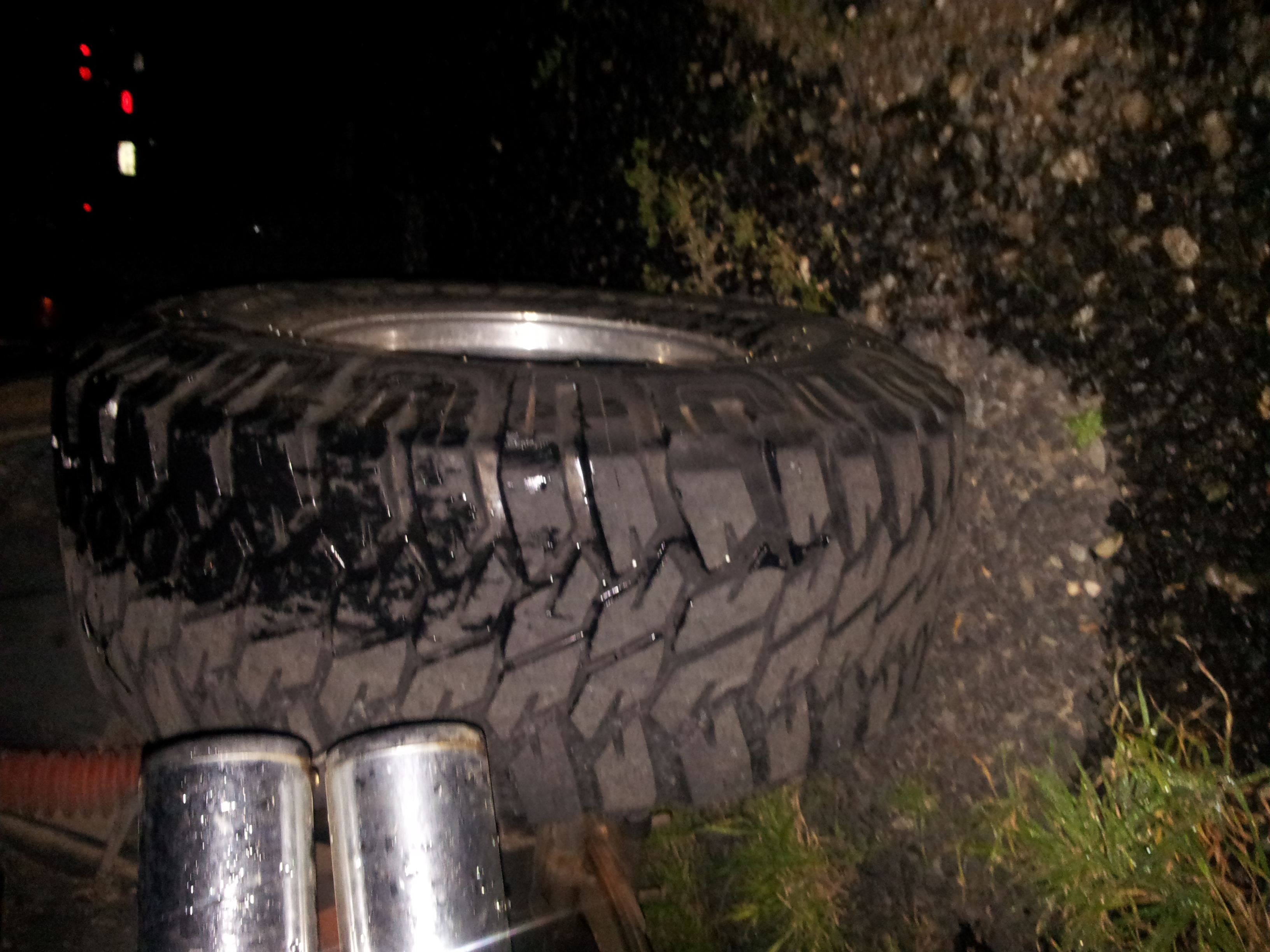

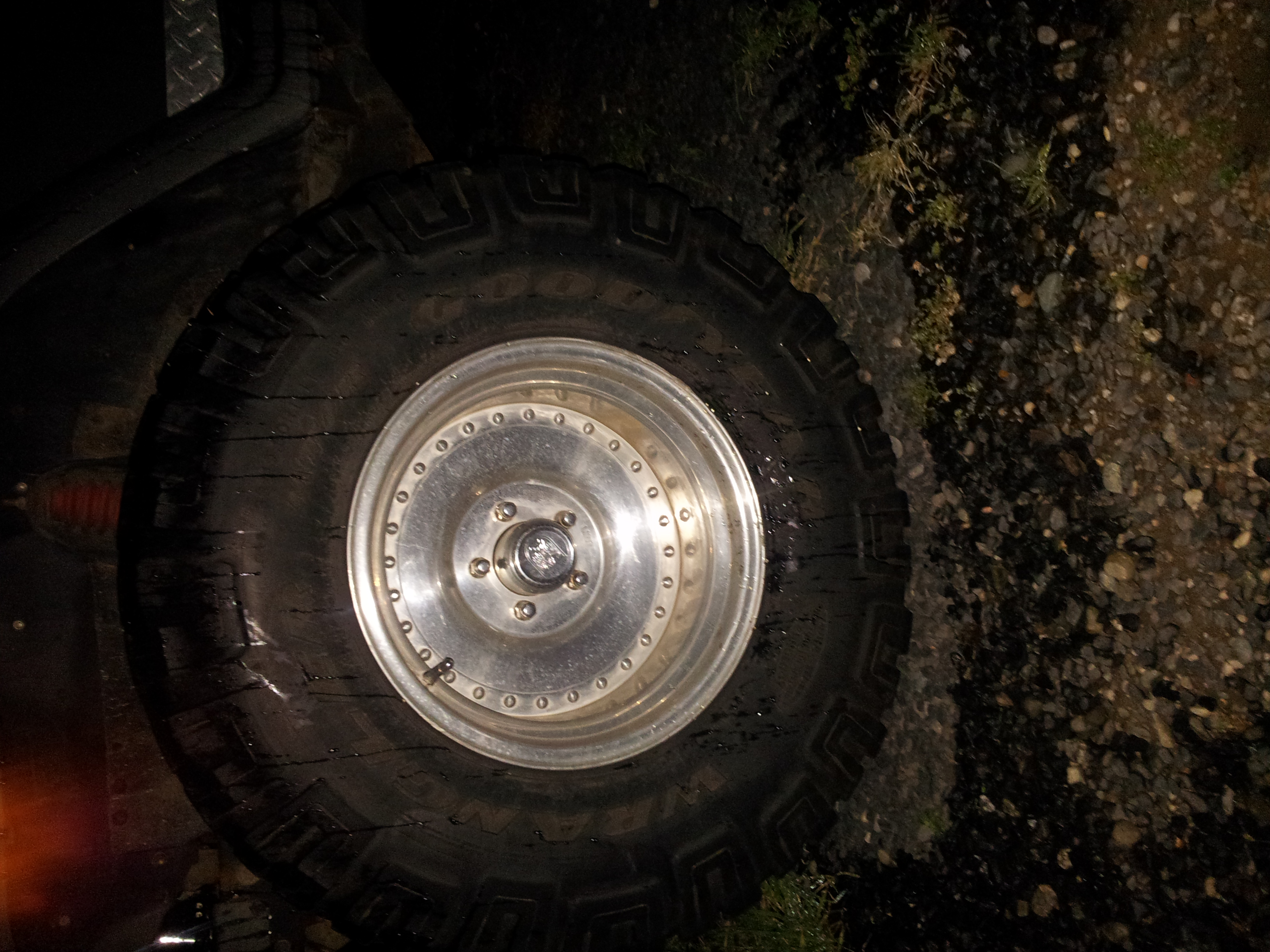

I don't air down, I've never had too, and I've never popped the bead. But I do have a lot of problems with wearing the tires and the front end swaying, like when I hit a bump or hole in the road, it goes to the right or left. I was told it was because of my rims being too wide for my tires.....I really want to get to the bottom of this before I get new tires.

The pulling to the right or left when hitting a bump in the road is called bumpsteer, and it has nothing to do with the width of your rims.
Bumpsteer is caused when the front track bar (panhard bar) and draglink are not parallel. As the suspension compresses it will push the steering to one side, and back as the suspension rebounds. Proper steering and suspension geometry will correct bumpsteer.
^^2x^^.
Being you have sway as well you might do a dry steer test and look for loose parts and movement where there should be none. Like TRE's, track bar, control arm bushings
Check your tire pressure.
Ans check your shocks.
