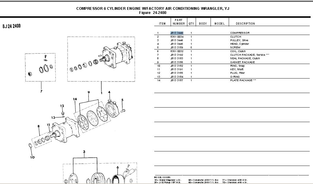

this is compressor factory air...
be sure to get pulley/clutch for serpentine.
Look for a sane year jeep engine in junk yard might be helpful - brackets etc.....
