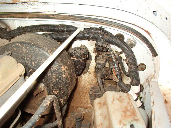

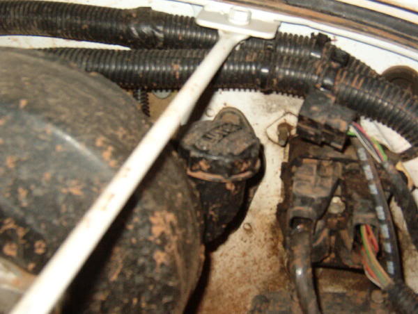

Re: What Da Heck Is It?
It's located right behind the master cylinder for the brakes, in the left hand (driver's side) rear of the engine compartment:
Mine's a '94 YJ, and the little lid you can see behind the master cylinder actually says "CLUTCH" on it....pretty darn helpful for folks like me. It's a pretty tight area back there, but try to trace the hoses from the bottom of that down to the clutch to see if there are any leaks. I guess before doing that, pop the lid off and see if there's the proper level of fluid in it. I'm guessing it's low from the symptoms you're describing, rather than it being a clutch problem. Let me know what you find out.

But opened it up and It was down about 1.5" to 2" from the top. I didn't see any markers that said full or add. where is the level supposed to be.
