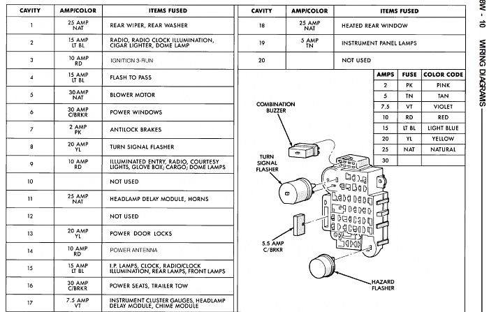

#1.any photo's of fuse box underdash that shows what fuse goes where ?.

To replace the lighter you have to take off the plastic cover for the dash, should be like 6 little screws and then there's just a couple that hold the lighter itself on, fairly simple job man, and here's a diagram of the fuse box.

thanks ,.....i got lighter fixed it was power wire vibrated loose i guess i pulled it off and put back on and it worked ...good fix...now i found a vacuum line burnt into .looks to go into a metal line on drivers side going under truck .....burnt at the valve cover bach passenger side near a canister and heater control valve lines ...can't find the other end ...too dark for pictures ...:redface:
