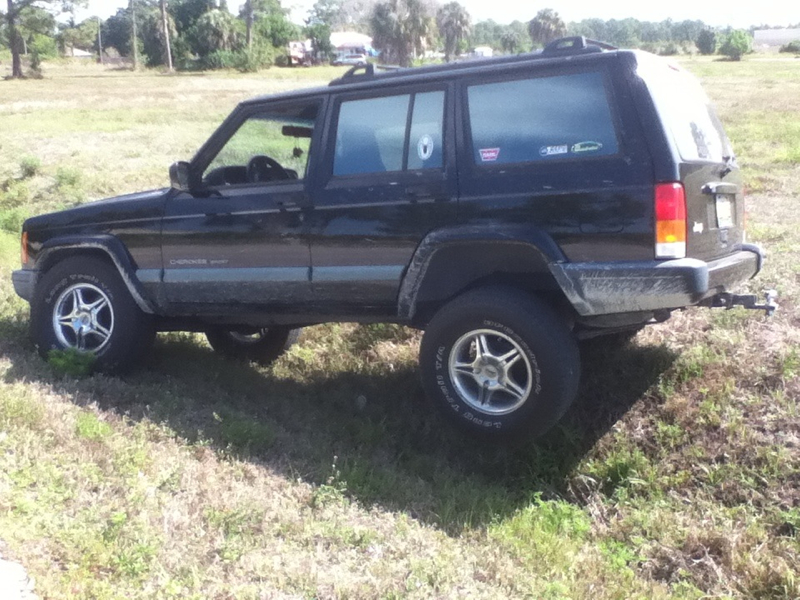

you want 30"s i had to lift mine 2"from stock so the 30s would fit without rubbing, 31" will rub but with 30s it looks great and i get a full range of motion for offroad use, only time they ever hit the fender was when i pulled this stupid stunt lol

heres how it looks on level ground with 2" lift and 30" tires
