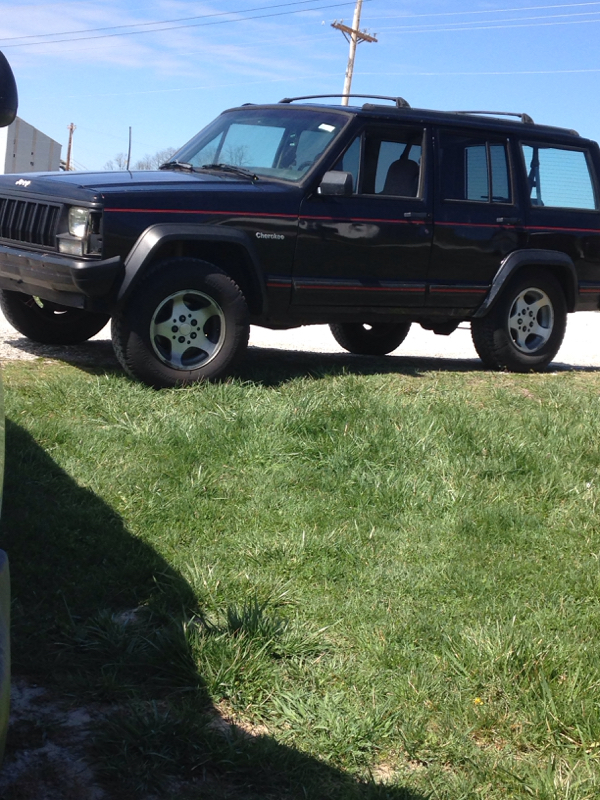

Hey fellow jeepers. I'm new here but I have my first jeep finally lol have had it a few months and done a lot to it and still more to do. Got a question for y'all tho. It's got new plug wires and plugs and distributor. And when shifting into passing gear it misses at hug rpm. Any advise and or suggestions would be greatly appreciated
