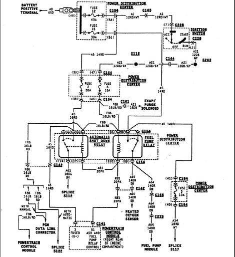

How are you with a test light and wiring diagram? Can post dia if you can use.

CK (Check) ign sw.
CK ASD.
CK Fuel ump fuse and relay
Does the crank sensor send a signal to fire the fuel pump? I have checked the relay and even with key to on i get nothing. There should at least be a 5 sec prime. Am not getting anything tho

start in PDC fuses relays.
Thanx gentlemen. Success. New crank and battery and we are up and running! Bought this 95 grand for $160. New governor solenoid tighten up the bands on trans trans filter and gasket set. And it's up and running!!
