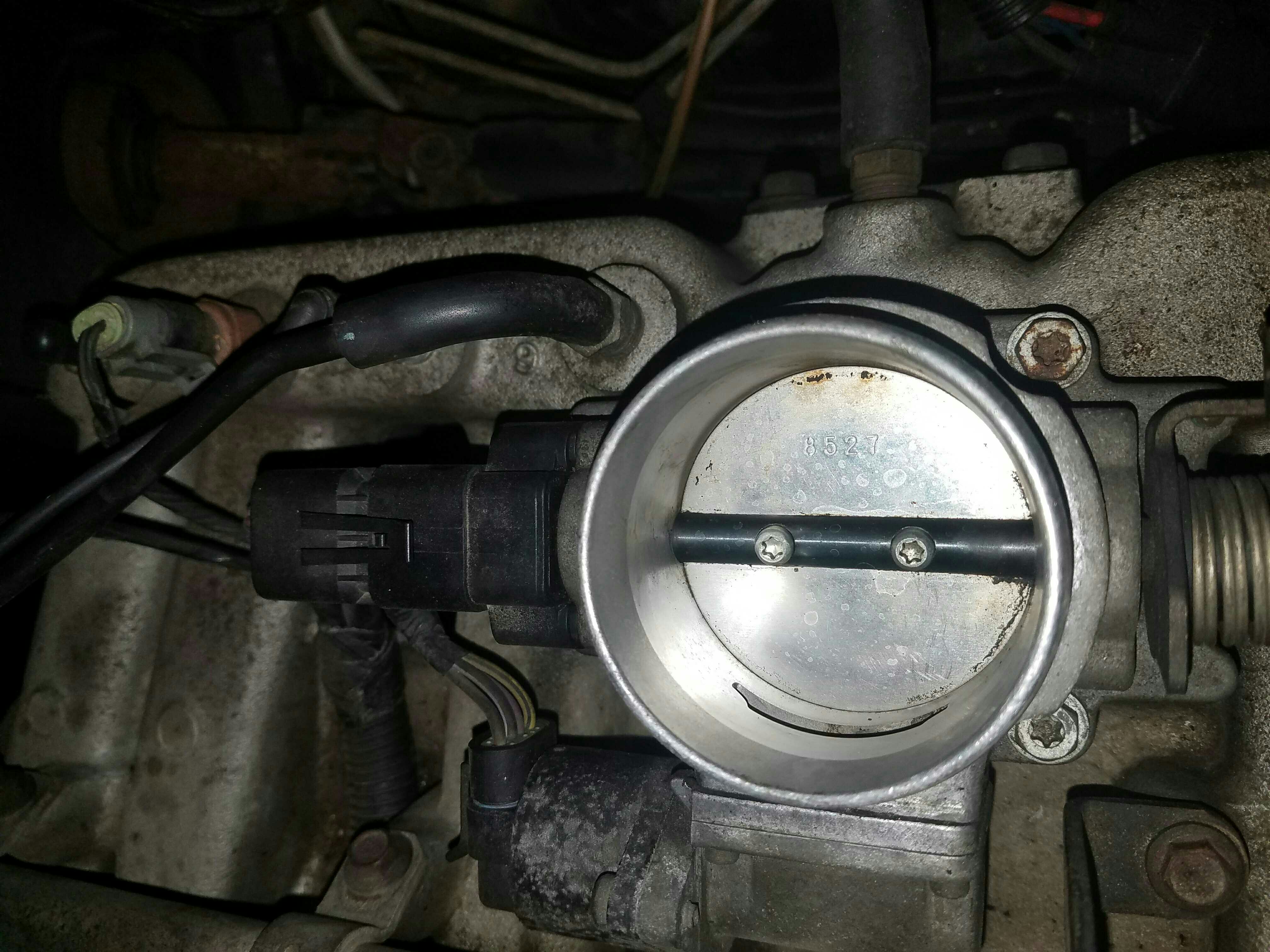

Throttle body is clean

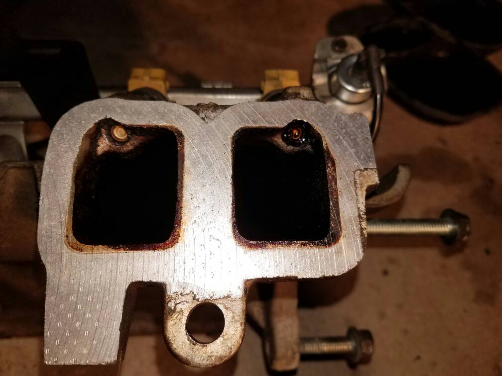

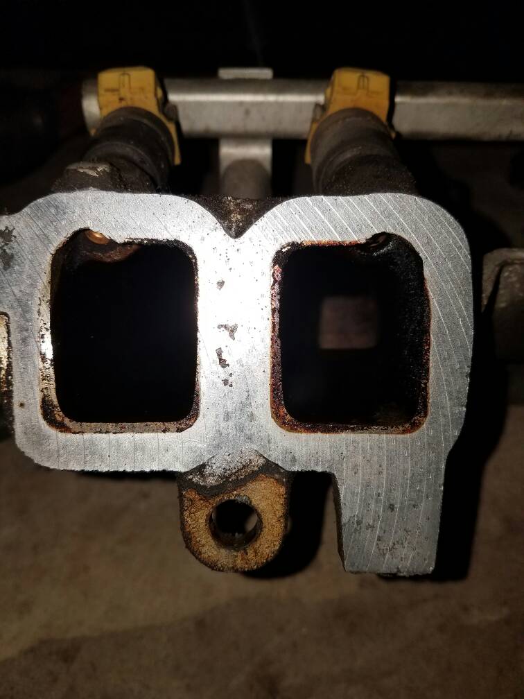

I will be running seafoam as soon as i am done putting new exhaust manifold on in process of doing now have tryed water but did no goo it seems or they were just worse than they are now exhaust manifold was cracked in 2 places and a couple of injectors were gummed up in intake manifold and i suspect was the rough idel problem but will find out tomorrow when its all put back together

If this solves my problem will be very happy also took a look at carb and made sure was as close to spotless as can be since intake manifold is off and easly accessible

If you have to replace any injectors go with the ones that have 4 spray holes. I got mine from Pic & Pull ( out of a couple of Neons)yours might have a different injector plug
