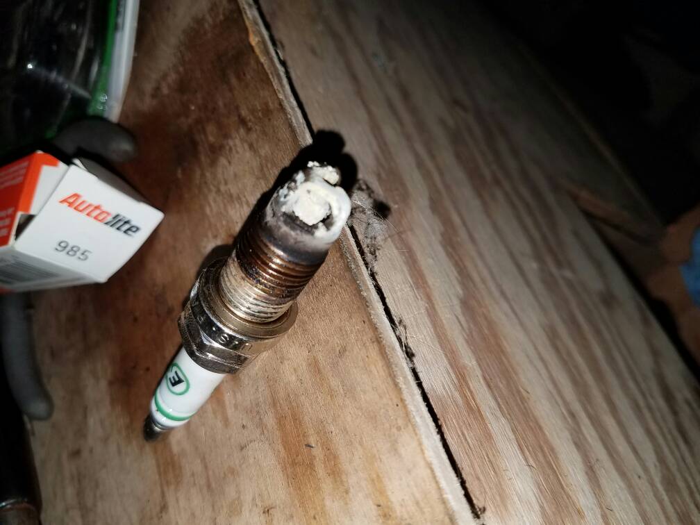

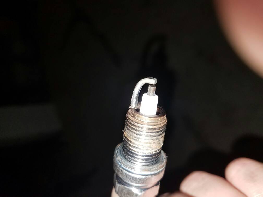

Dont know if it was running rich or lean as was getting a little oil in cylinders from valve stem seals that i just fixed ill upload a pic of sparks befor and after stem seal replacement
