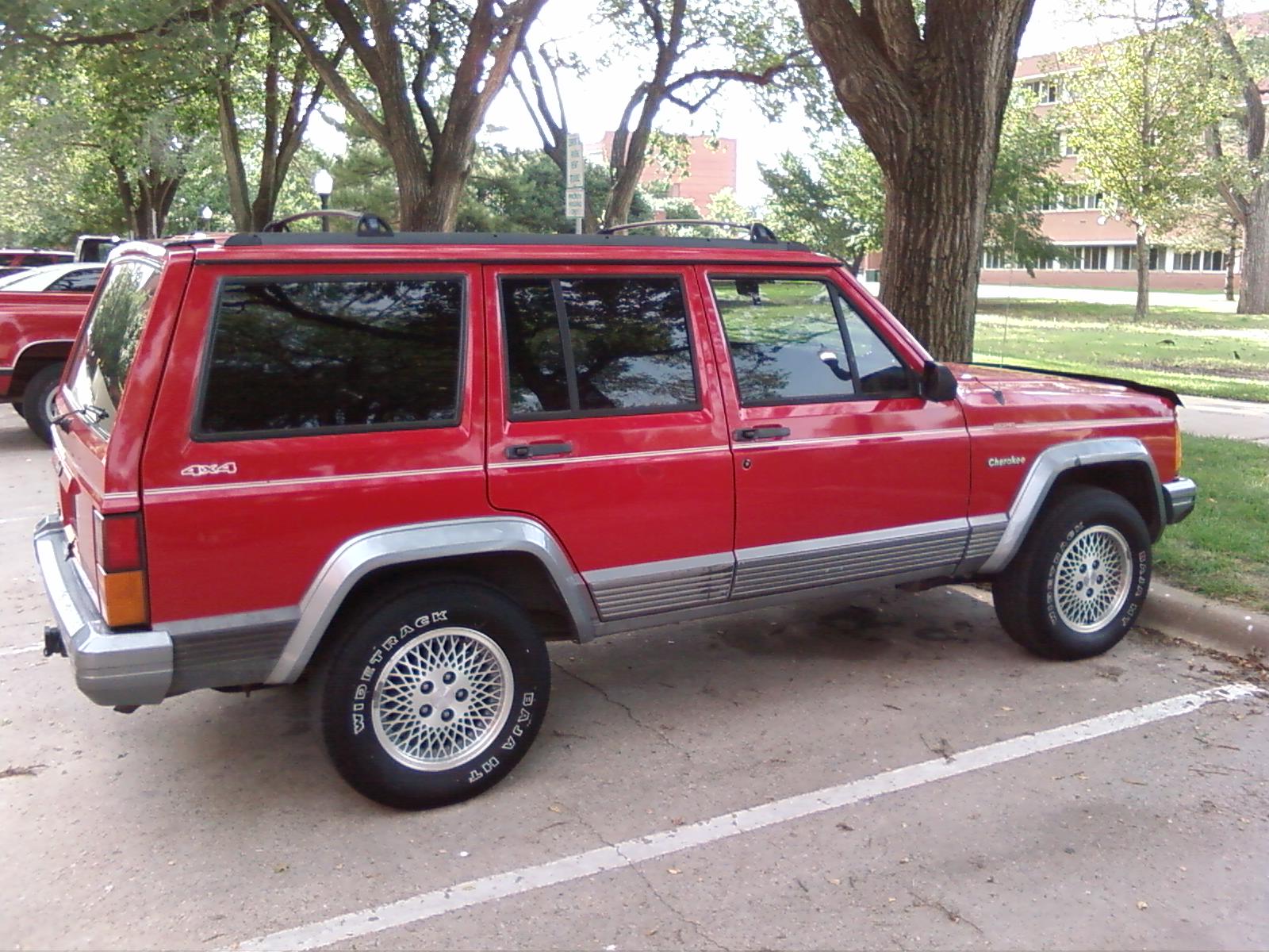

Sorry this is so long but I figured I would atleast try to get some help before throwing in the towl. I really don't want to part with my Jeep Cherokee just yet (its loads of fun and I have great memories with that bad boy!). Any help is GREATLY APPRECIATED.
[See attached photo. This thing is a beauty. Hopefully you'll feel sorry for it... LOL]
