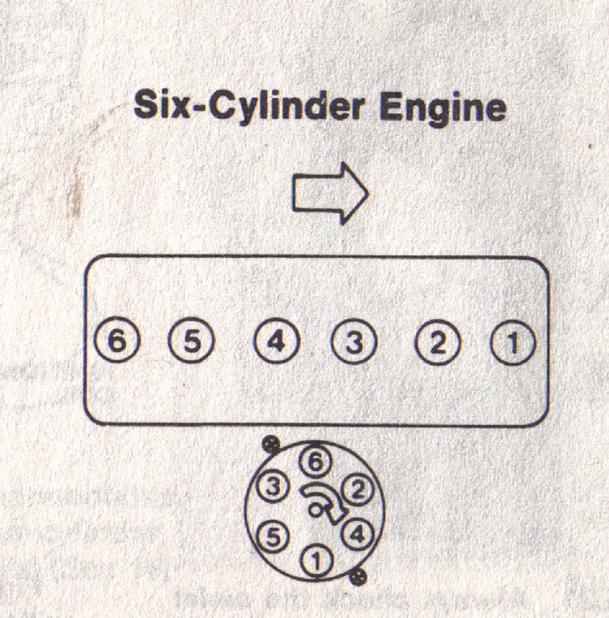

Any chance the cap could be on 180 degrees out?
bet you put wires back on wrong heres a diagram so you can go back and double check
