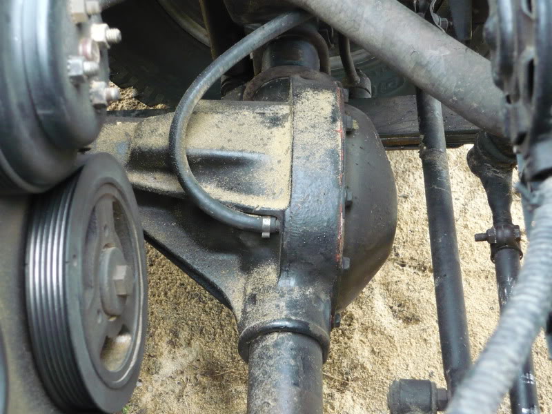

So now I find myself working on an 89 YJ that was someone else's baby in times past. Its the 4 cylinder with the AX-5 and regular axles (non-LS, Dana 30 on the front). All the vacuum hoses are hooked up to the vacuum motor, but there is also a large (3/8" or so) vacuum line coming off of the top of the differential housing that ties to nothing. Also, the linkage looks correct at the transfer case.
Can anyone help me figure this one out? Could someone have locked the front axle on purpose and what would I look for to undo that? Am I just looking at needing to reconnect the big vacuum hose somewhere? I didn't find this thing on he Chilton's diagrams!

That is a breather tube. Goes up under the hood zip tied up so water is less likely to get in.
The vacuum shifter on the front axle may be froze up. It happens and their cheap to replace. Also Some one may have mounted it backwards so that it would stay in 4wd all the time.
Thanks for the help and the Picture! Guess that aint a vacuum line after all!
I'll try monkeying with the vacuum motor tonight. I knew that vacuum pump was good for more than just bleeding brakes, ha!
The rubber hose on the front axle/differential is a breather hose. the other end should be attached high on the firewall to keep water from getting in.
