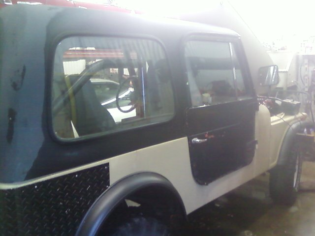

Hey guys I'm very new to jeeping so try and take it easy on me. I have a 78 cj7 304 auto with the quadratrac set up ( which I absolutely hate) I'd like some ideas as to a replacement setup I know I have to change the rear axle just want some ideas as to the rest I'm also wanting to go with a manual trans. Thanks

A lot of discussion to be had on this swap but here is my two cents:
Transmission:
-18 transmission (CJ or Ford version)
Transfer Case:
-Dana 20. Easy bolt up to the T18 (Will need to change rear end.)
-1980 Scout Dana 300 (Will need to change rear end.)
-CJ (round hole) Dana 300 (Will need to change rear end. Only doable with a CJ7, not a CJ5.)
-Large Hole Spicer 18 (Can reuse the existing rear end, you may have a Dana 44)
Rear End:
-1972-1973 Commando Dana 44 (direct bolt in)
The T18/Dana 300/Dana 44 combination is the best combination that you could get as far as bolt in components. Why do you need to change the rear end? Is it broke? If not then you can make the AMC 20 as strong as a dana 44 by welding the axle tubes to the center section so it won't spin (Unless it already has) And some aftermarket one piece axles. Maybe i'm missing something. Is the quadratrac axle different than the others? Any three, four or five speed transmision out on a CJ will work for you. I'm a little partial to the T4 and T5 transmisions and dana 300 transfer case myself.
The quadratrac transfer case has both outputs (front and rear) on the same side, just like the old model18 tcase...so the rear diff isn't centered...think wagoneer...
