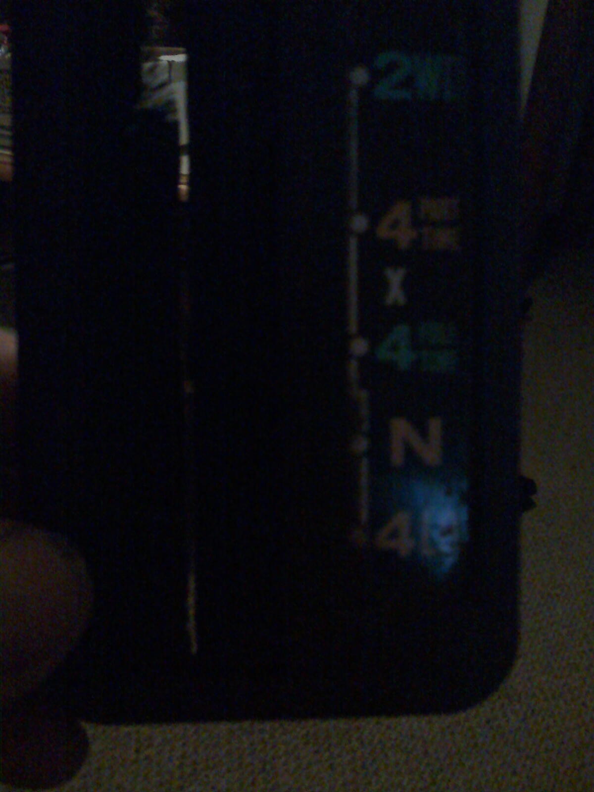

pic of shifter plate could some one have swaped or is this correct

Your shifter bezel is for a 242 so the 'fulltime' position doesn't apply to your 231. You can snap in a 231 bezel if it bothers you, very plentiful in the junkyards.
