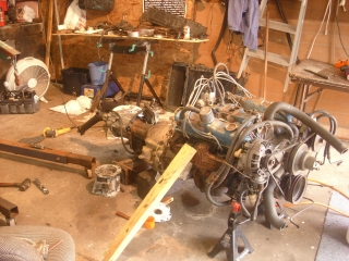

cut off 1/4 inch of the 231 input collar and re-drilled the 203 adapter to fit the 231. have the wiring ready to convert to mopar/gm from the jeeps. next hurdle is motor mounting and some pipes ! but all has gone very smooth so far. everyone ready for national topless day on May 8th ?????? (except me ! )

Is that a BIG-A$$ alternator I see on the front left side. Looks like it's 8" round

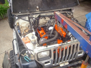

yeah it is ! had a morrisson power pac on it too ! i'll wait to see what i can do with that later ! here is the fit so far.

ok. i am officially an idiot. never looked at the block casting , just assumed it was a 318 cause was told the all adventurers came with them...BUT never thought it might not be the orig engine. its a 360 NOT a 318.....cool huh !
Cool..xtra cubes you didn't know you had....like finding a $20 in those old jeans.:D
lol yeah ! new radiator came a couple of days ago..( found the site right here on jeeps ! ) got the motor mounts welded in today. next up is hooking up the mopar ignition using a gm module and bend up some pipes for the beast. so would it be cool to sport a mopar ram above the jeep logo now ?????????????:D
