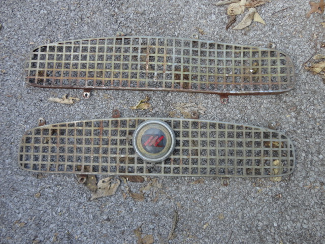

3) and finally..what are these to...?
Picked up a front windshield along with these two that's really narrow left to right and is curved back on the bottom outside corners resembling something like a '63 Chevy C10. Have no clue what they're to, or if the windshield and grill parts even go together.

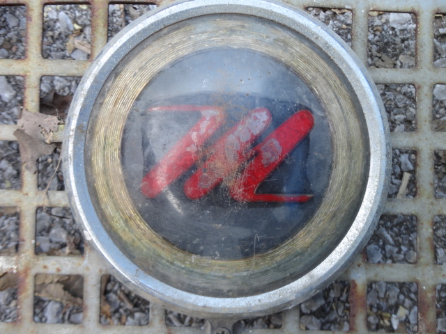

Turns out these are grills to a Nash Metropolitan. I might try to clean these up some and hang them on the wall. Any idea what I could do to get them looking a little better?

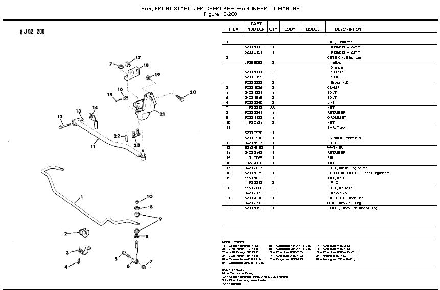

I'm actually replacing the two front sway bar links (vertical pieces from the axle up to the sway bar), along with associated bushings and the two bushings that cushion the sway bar in the two brackets that attach it to the frame.
Is #11 in that pic the track bar? I believe I replaced that one, actually with a Moog a few years back.
I think they'd look great as is hung on the shop/garage wall! I suppose you could clean them with a brillo pad.
