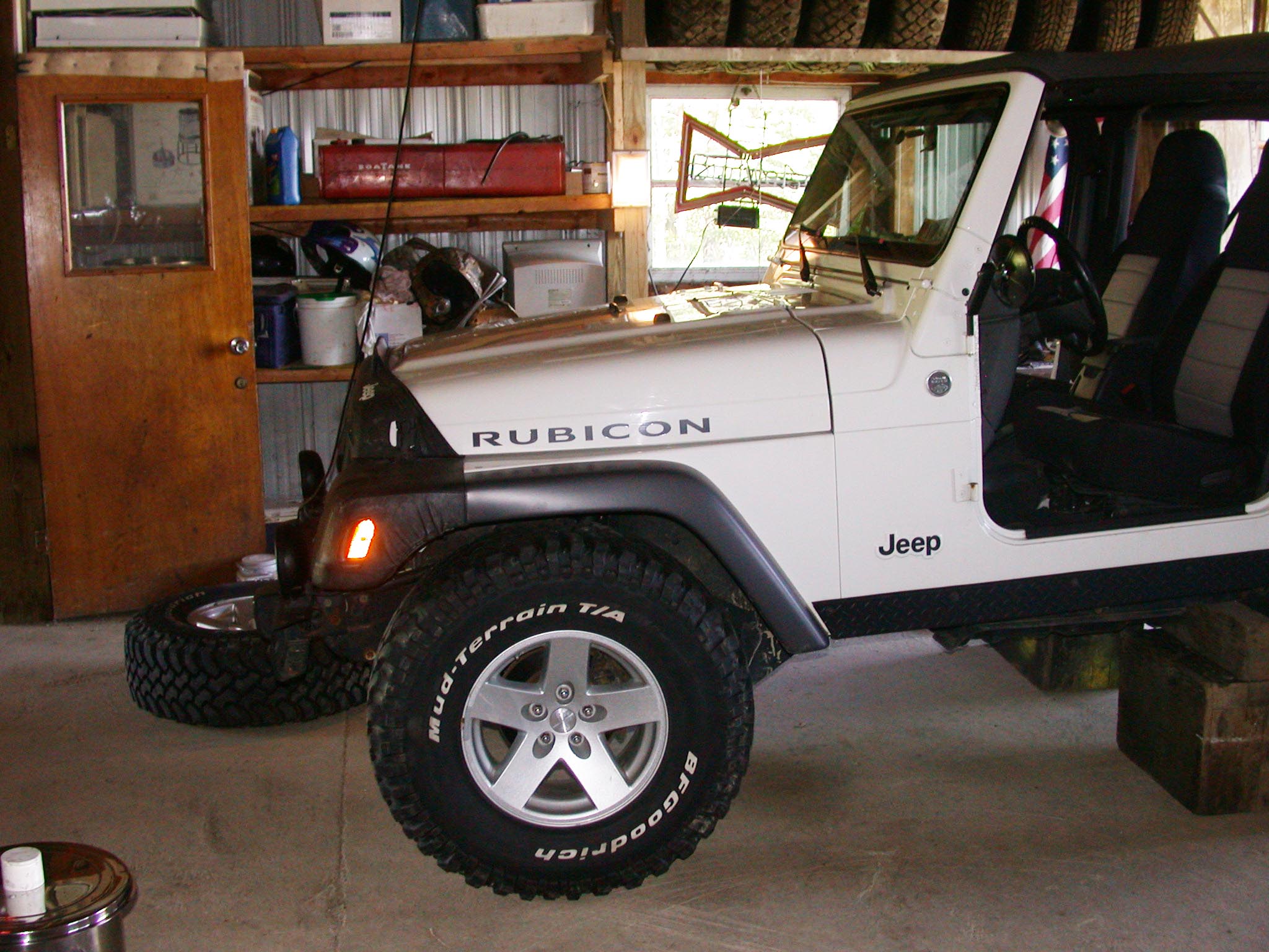

5695 is before, with 33" tires on stock jeep (1.5" from tire to fender)

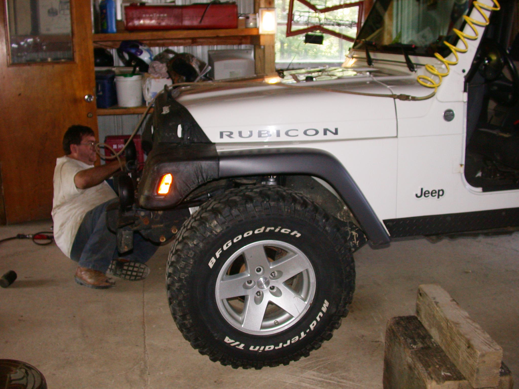

5706 is after, with the spacers, shocks and jks discos (4" now from tire to fender!, it's about 7" in the rear)

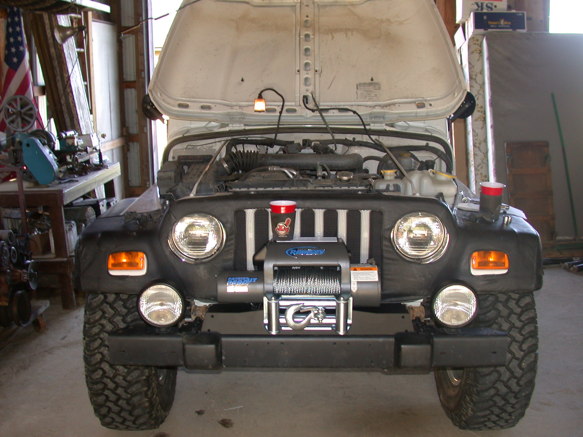

5710 is the ramsey 9500 ut winch i won at penn's woods jamboree (have to install the remote yet)
your online instruction were fantastic, took only 4 hours, only problem was the tops of the front shocks...had to torch the nuts off
i also have to adjust the turn stops so i don't grind the tires

You could adjust your steering stops to keep from rubbing your lower control arms at full lock.
