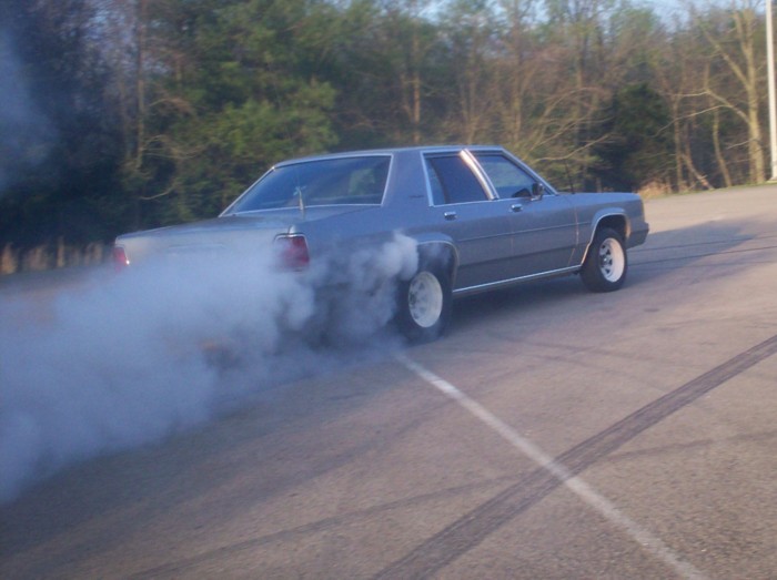

I'm just looking for some insight on the two engines, I'm looking for a new dd because my current has a 5.0 police interceptor and does not get great mpg even though I get 21 highway and 13 to 16 on back roads and city not bad but the car is going on 20 years old and it's just time
and of course I'm a jeep person. I have been impressed with my 4.2 in my J10 and therefore I’ve been looking for a low mileage 96 to 02 wrangler with a 5 speed manual, hardtop, full doors, hardtop because my aunt has a 99 Chevy tracker and her soft top is a pain and cold in the winter and it leaks alot,
so I’m looking for the pros and cons of both engines, has anyone owned both engines and can say they liked one more than the other.
and what if any problems have showed up most common in both, Thanks for the insight ahead of time.
Picture below is my DD for now.
