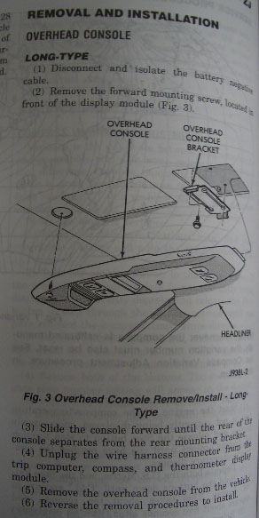

I need to remove the OH console on my 99 Grand Cherokee in order to replace maplight parts. I removed the single phillips head screw but would not come off. Am I missing something? Did not want to force it off. push button map lights do not turn off. What is proper way to remove? Thanks.
This should help:
Just to add to the last great post. Be careful with that first screw. I did not remove it all the way and tore the headliner when I pushed the console foreward.
