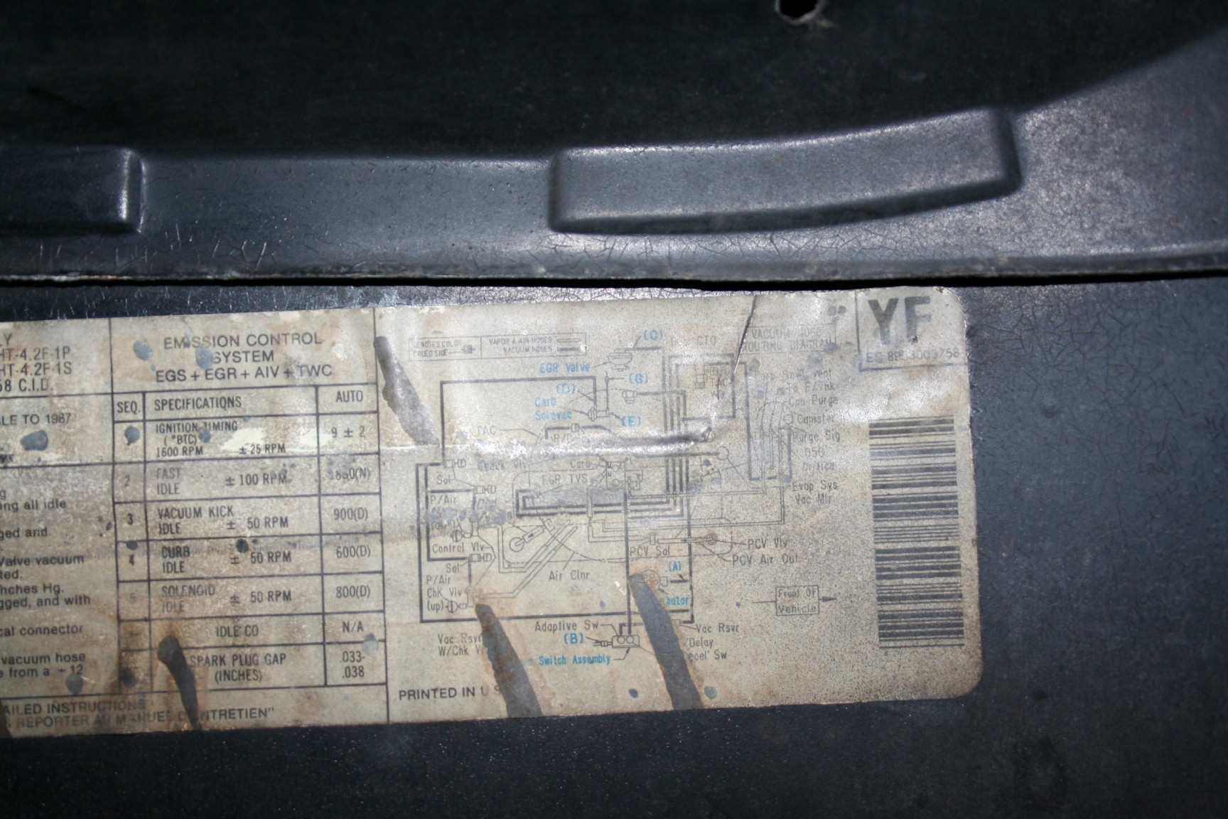

OK I did the Nutter Bypass and while I was eliminating the miles of wire and vac hose I found the RED vac hose from the front axle and it was just plugged. I was given the 1989 yj recently and I haven't ever driven in 4wd. my question is, where should the vac for this line come from? I have many ports available from the carb and the manifold.
Ok Bert,My 87 is the same as my friends 90 and the "hard" red plastic line comes up from the harness goes into a "T" with a check valve. One side goes to the large hose on the canister under the battery,the other end runs up around the rear of the valve cover ,"t's" again with a hard metal line which eventually goes to the manifold port just above the EGR valve.
Both his and mine are smogged in California and pass all inspections.
Copy of routing attached to help you.
Thank you for the info. I don't have a copy of the vac diagram under my hood, go figure. You say that the line goes to the storage canister then behind the valve cover to a T, one side ends up at the Manifold Vac port above the EGR but where does the other side of the T go. Thanx again
