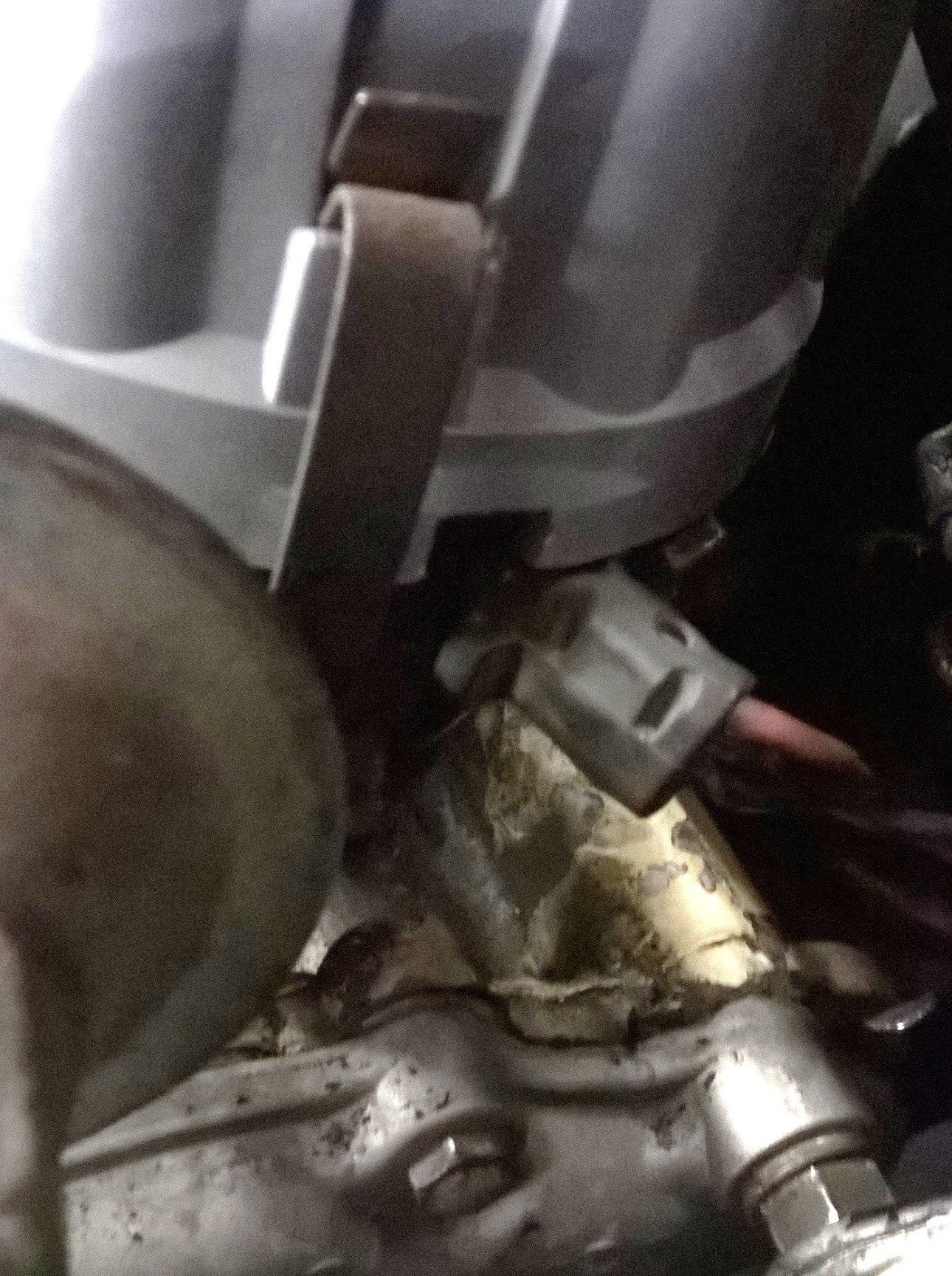

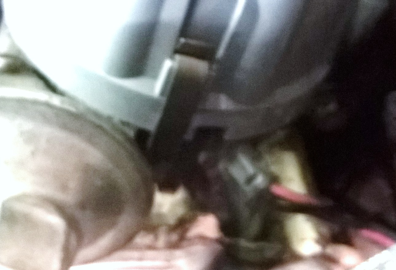

Hi gang, I'm finalizing the cylinder head repairs and comig down to the wire, I noticed the distributor cap's relief for the distributor wiring is about 10* off from it's entry into the distributor, allowing crud to get into the distributor. The ignition is Ford EEC-1 from the looks of it. I swapped out the Standard for an Echlin at NAPA and it is the same, what's going on with this?
Im not sure gus. They may have given you a prestolite cap. They were earlier distributers..
From another forum they thought it is for an alignment tab on the disributor.
Yes, that notch is to align the cap, should be a tab on distributer body. I was under the impression that the caps notch wasn't lining up with the distributers tab.

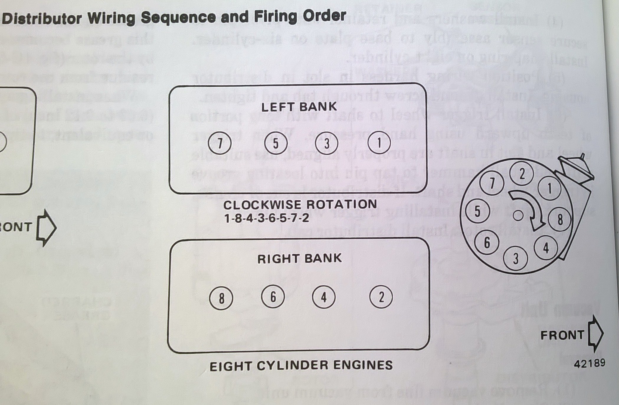

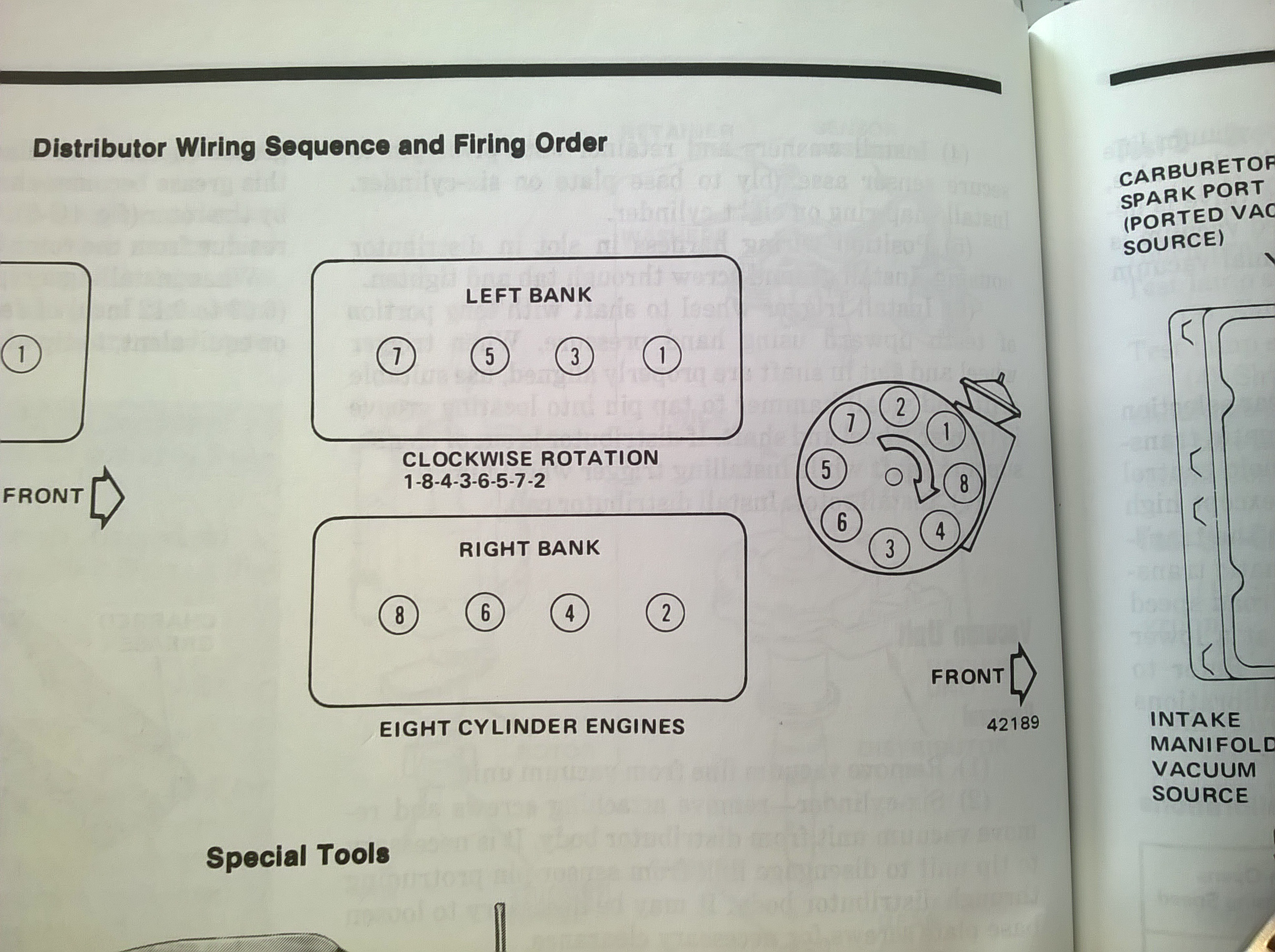

I reckon I went wrong with the orientation on account of the diagram in the TSM where the cap shows the No. 1 tower near the vacuum diaphragm;

NAPA ordered in a cap of another color (as in horse of another color) this one is an Echlin (brown rather than gray) with the tab where it should be. I think it's for a Ford, which would follow since 'Black Betty' has the Ford EEC-1 ignition system. The box is in the Jeep now, I'll post the pn later.

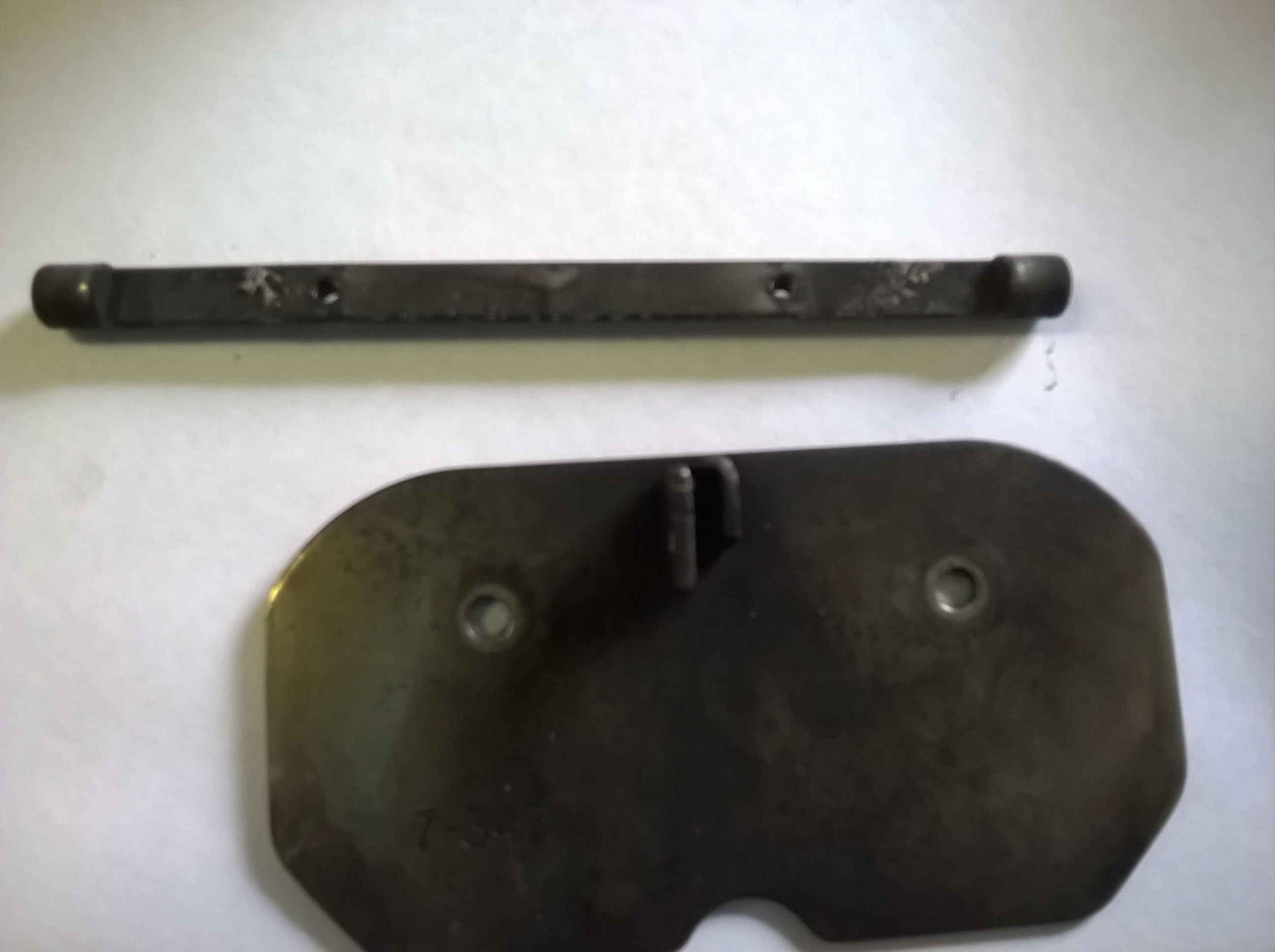

So, saturday morning I get into the AFB that I pulled the night before. I noticed carbon was still built up in the air horn. Disassembly found two gaskets between the air horn and the throttle body. Carbon was throughout the carburator and the floats were misaligned and out of specification. All of this after "two rebuilds" of this $300 carburator rebuild.004.jpg012.jpg
Bringing these and other pics to the "experts'" shop I softly and diplomatically asked for a part or entire credit as evidenced by the shoddy work in the photos. He remarked "that double gasket was there when you gave it to me" (So why didn't he make it right during the process of the 'rebuild'?) And when showing him this photo he said that "my carb cleaner wouldn't remove that stuff" This was no kid I was dealing with.
