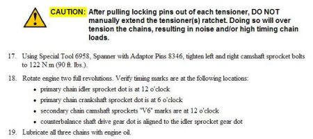

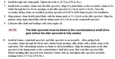

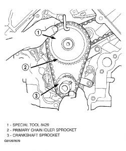

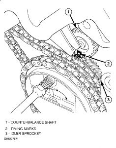

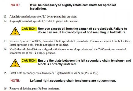

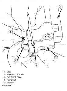

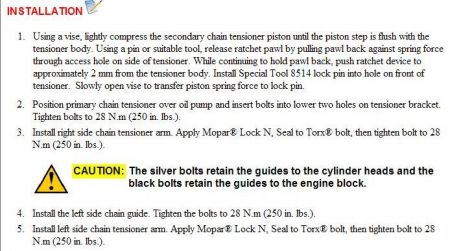

who out there has the trick to setting the timing for an '05 liberty w/3.7l. I have all the timing parts in place with the crank and idler gear marks spot on. what is left is the cam gears and bringing those marks to the 12 o'clock position. Number one is at tdc. The book isn't real talky about setting it up. Any help so I can get this thing outta my driveway!:roll:
You may have already gotten this, but hopefully this can help someone
