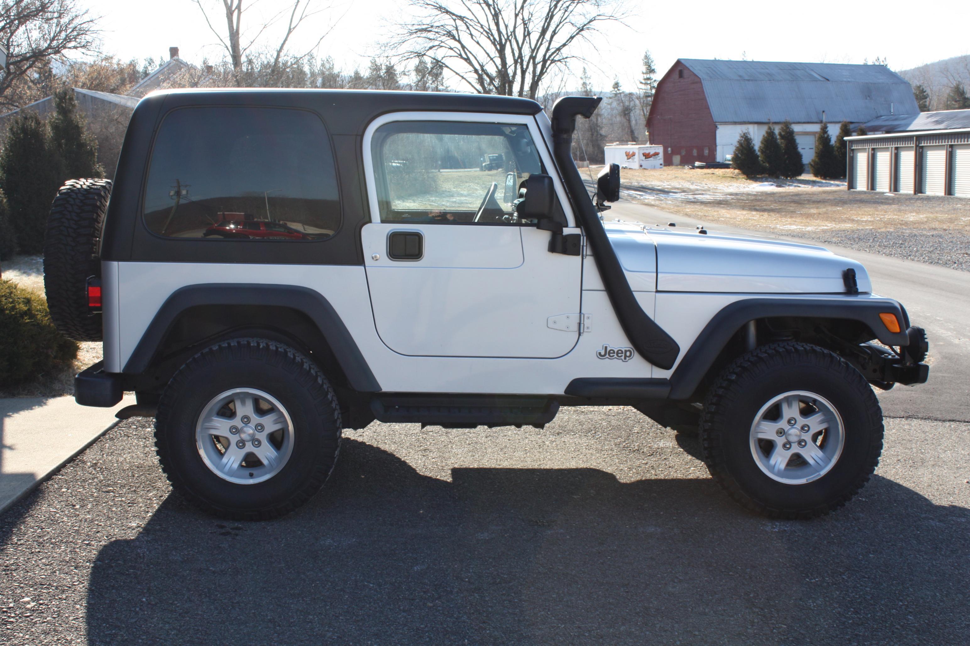

I went with a Rough Country 2.5 inch progressive lift right for Rough Country. com. I love it because it was cheap, the jeep still rides smoothish and its easy to install. Here is a picture of my jeep with 31x10.5 treadwright tires on 15 inch rims.
