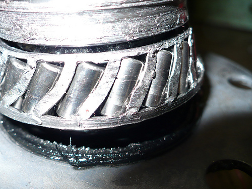

One week later I smelled that old 'hot bearing' odor
I had become so familiar with, pulled the axles again and saw the damn roller bearings formed a 'conga line'. So I made a trip out to Mac's Jeep Parts and we pulled a Dana 44 out of an old Jeep Scrambler, installed a Lock Right differential and new bearings throughout and I've not had any issues since (knock on wood). After turning in the AMC 20 for core we noticed that the troubles lied in that the reason the inner wheel bearings were welded to the axle shaft were that the axle tubes had become crooked from the diff~!
