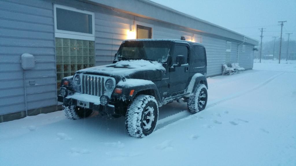

Went out playing in the snow, we got about 6.5"
That truck in front of me wrecked about a mile up the road

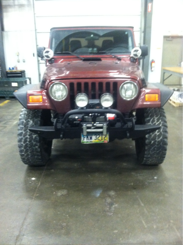

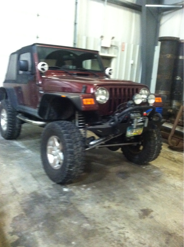

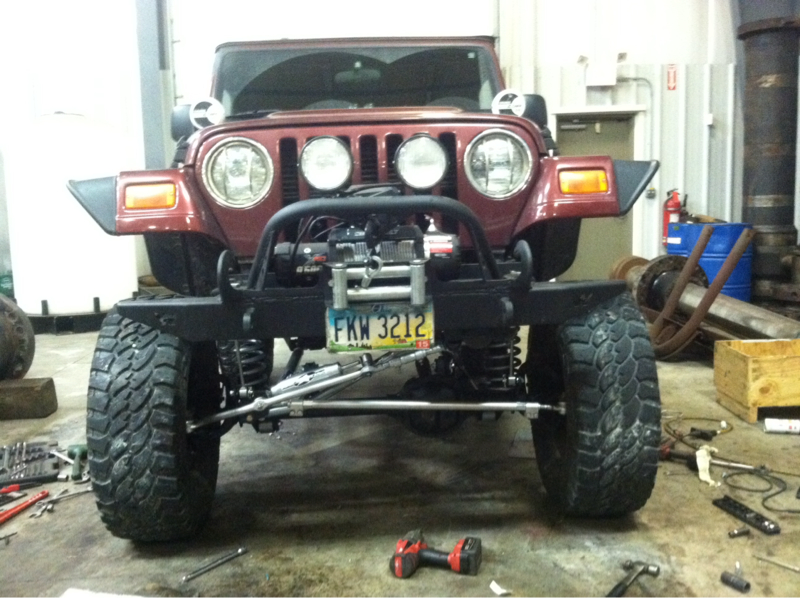

I made a new front bumper using my old warn bumper, a harbor freight winch mount, a stinger I bought off of eBay for $11.. I cut it and widened it 10". And some lifting hooks. After about 6 hours of plasma cutting, welding and grinding this is what I ended up with.

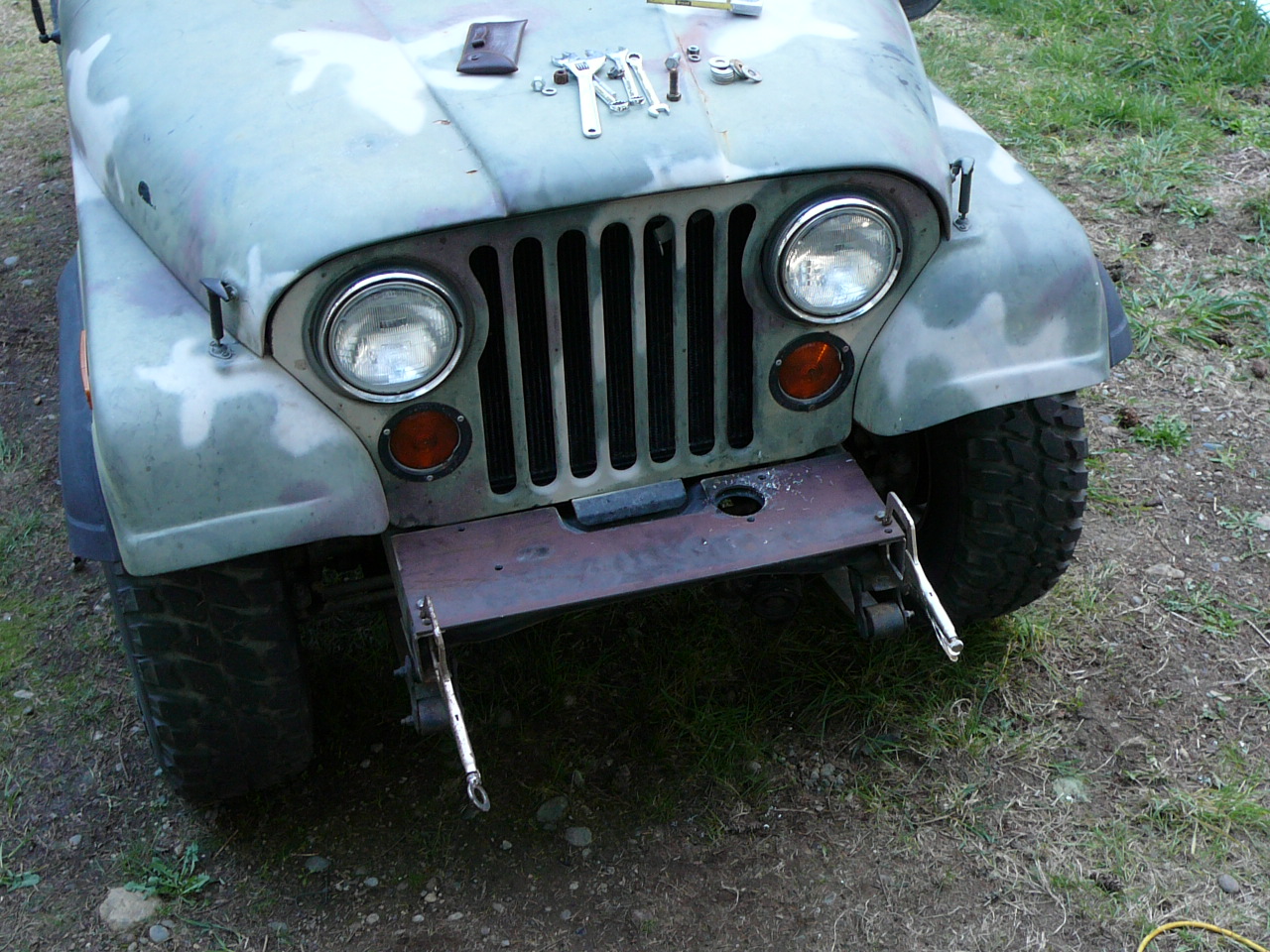

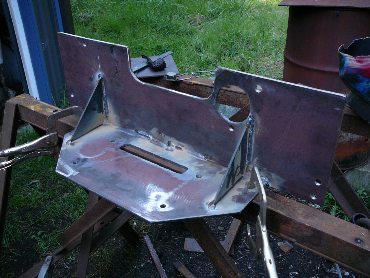

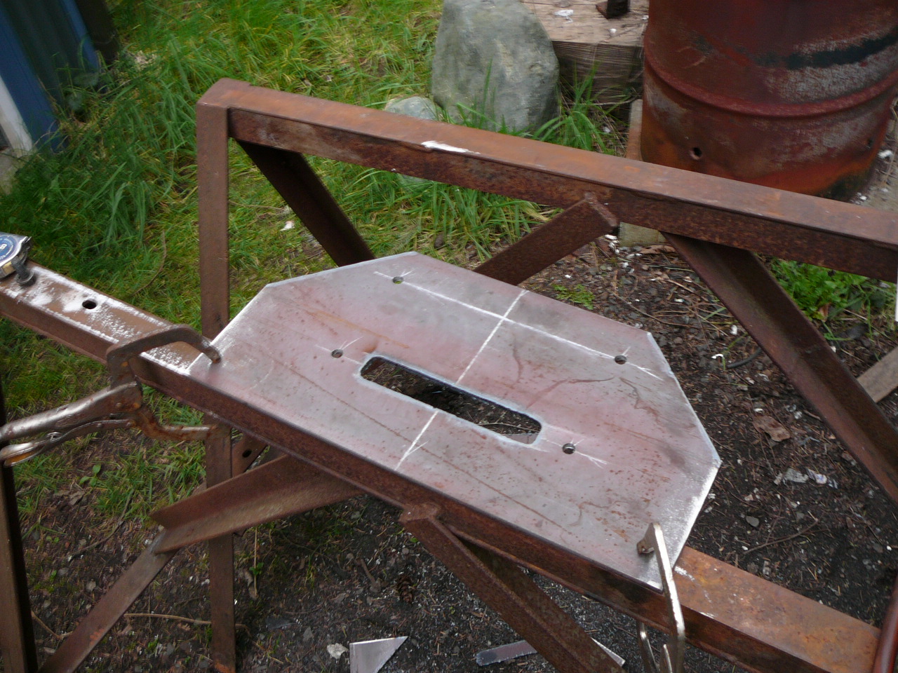

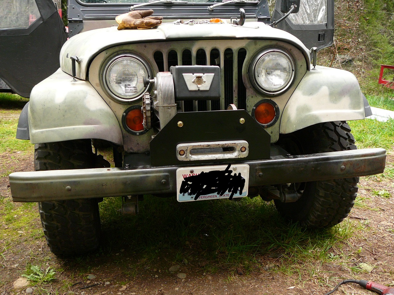

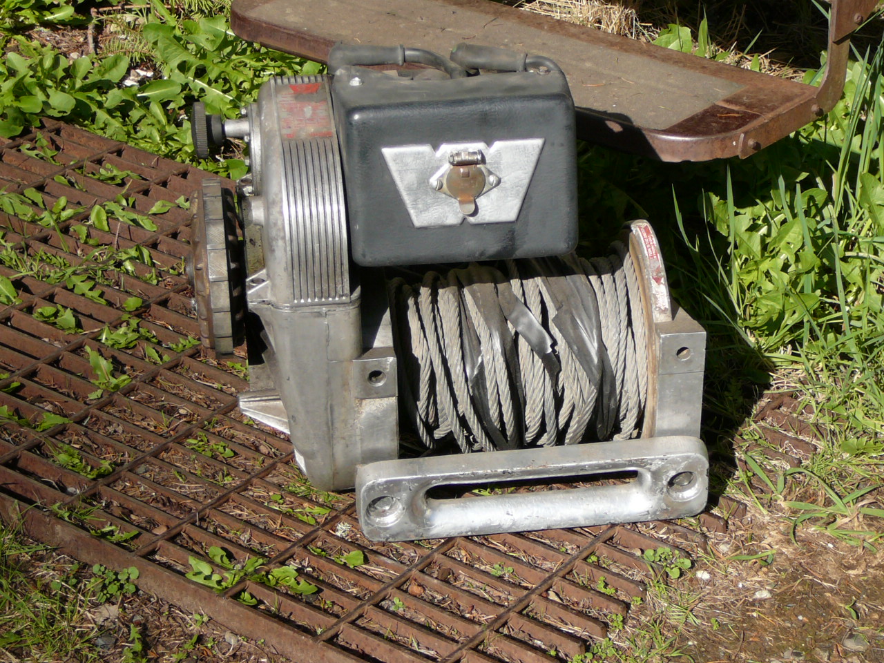

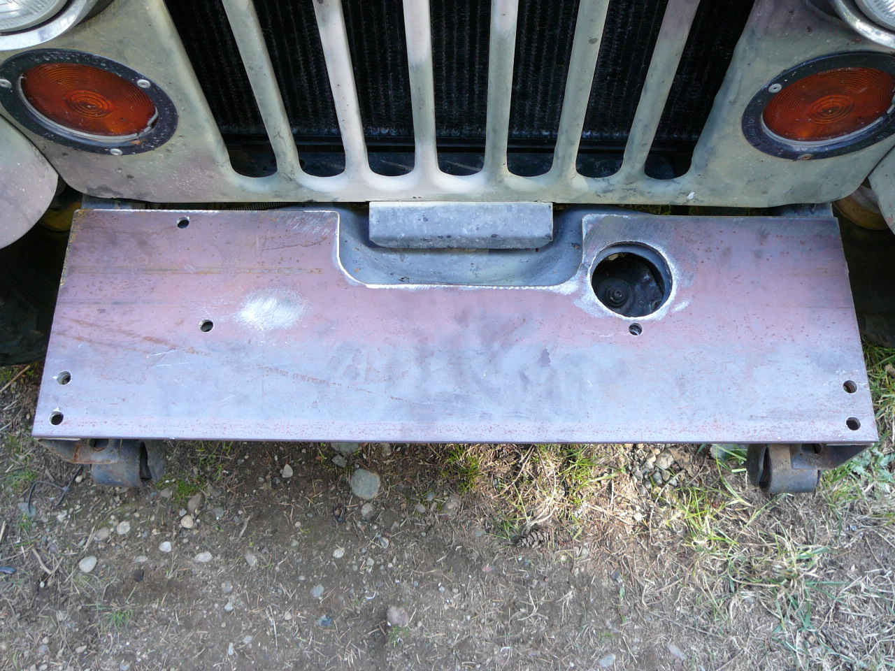

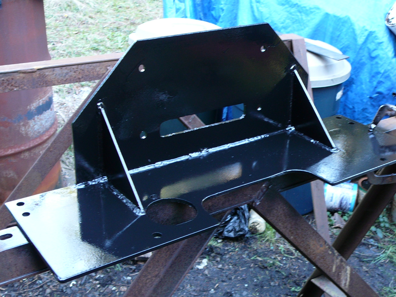

I started on a winch mounting plate. Going to use the old flunky bumper for now. Next time it gets bent will consider replacing it.

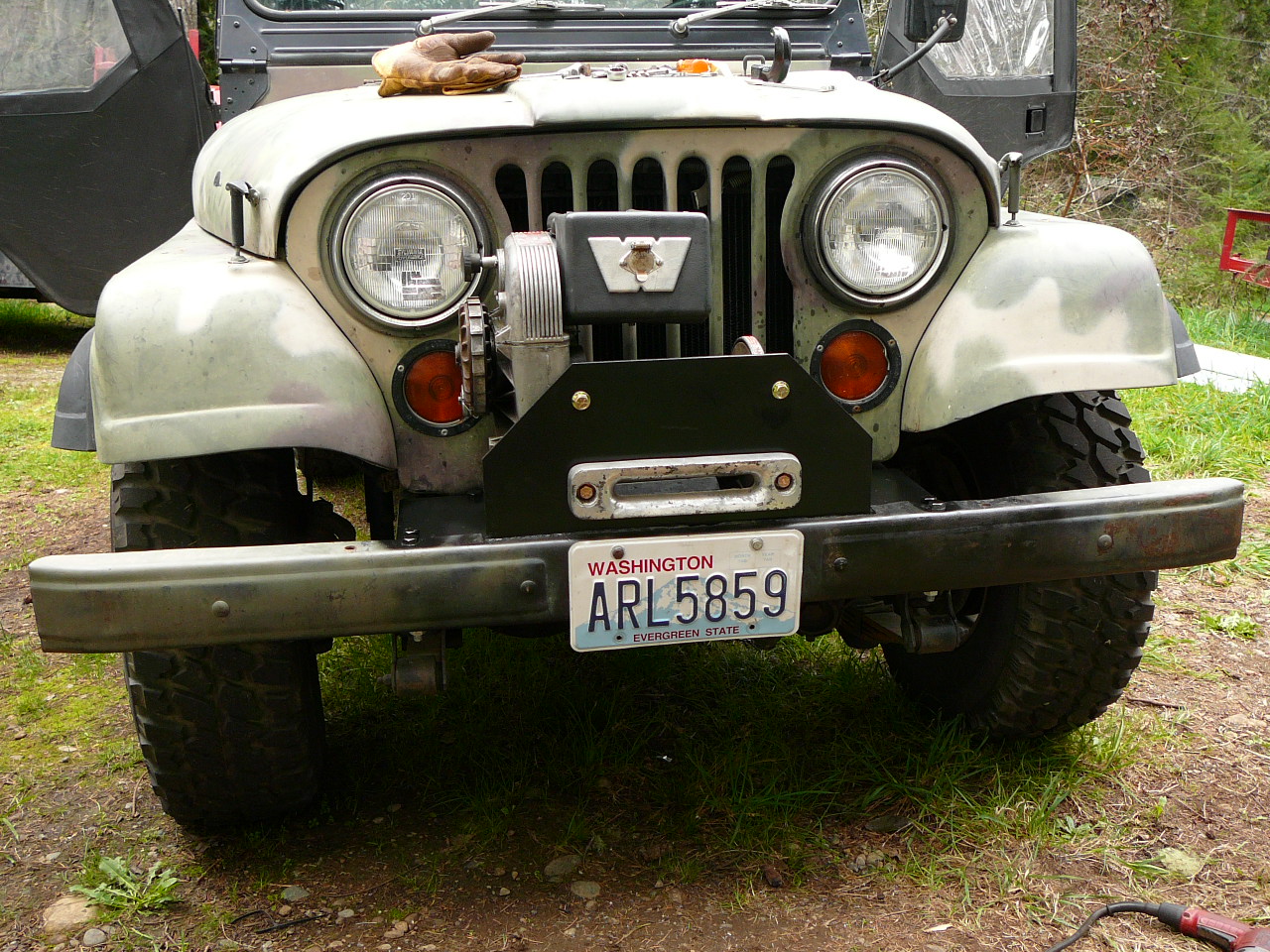

P1080828.JPGToday I mounted the plate and winch. Need longer bolts to mount the tow hooks. At my pace this project should be done by the end of next month. :rolleyes:

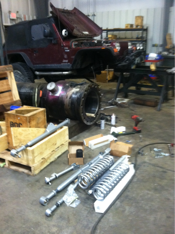

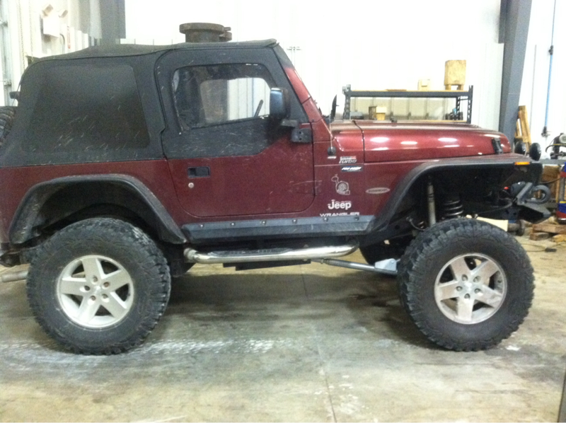

Halfway done with the lift, probably finish it up next weekend. <img src="http://www.jeepz.com/forum/attachment.php?attachmentid=20501"/> <img src="http://www.jeepz.com/forum/attachment.php?attachmentid=20502"/> <img src="http://www.jeepz.com/forum/attachment.php?attachmentid=20503"/>
Longer swaybar connectors?? So it functions properly.
Adjustable track bar?? To keep track bar parallel to steering and minimizing possibility of DW.
I bought the entire rubicon express 5.5" long arm kit complete. Also a lock right for the front axle because it's un noticeable in 2wd on the street. Plan on a ford 8.8 next year. Kit has everything you mentioned and more , very nice kit, my jeep also has a 3" body lift that was on it when I bought it but I will be taking it out as soon as I'm done with the re lift.
