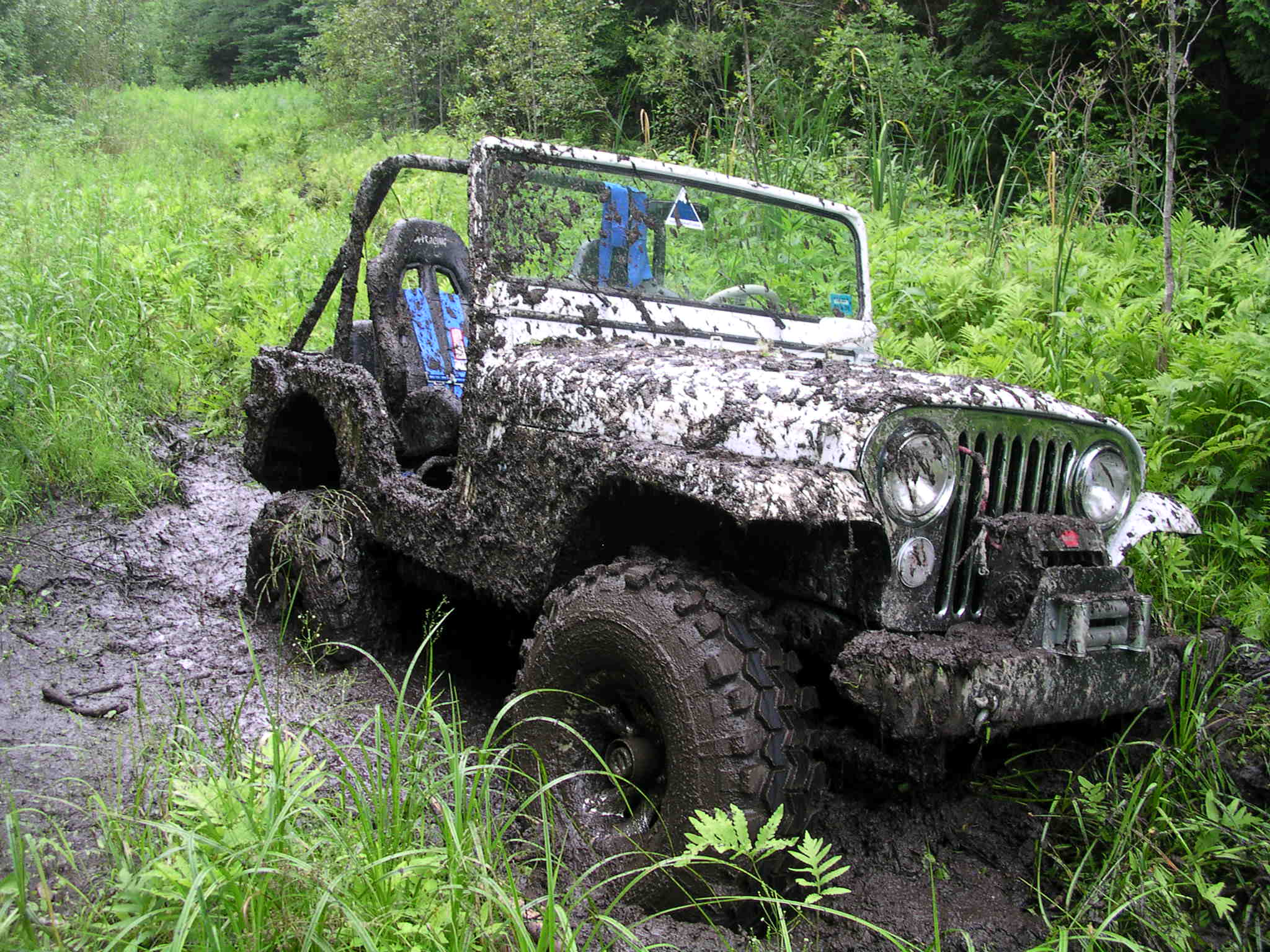

Hi guys. Wanted to share my 73 cj5 rebuild project with you. Iv owned/rebuilt many of jeeps over the years and each time I purchase another jeep I customize it in ways better then the previous jeep owned. Learning as I go and taking on the project yourself can be a fun experience. I'm not going to lie frustrating at times but all said and done well worth it. This particular project jeep was purchased back in 2005 site on seen for $3000 yes 3K! We spent top dollar on it only because of the fact this had the original steel body which was something I really desired. There were only a couple years with this particular body that had this style of logo. No surprise the jeep was in much worse shape then planned. The jeep was supposedly in running condition but was a very sad site. Really the key parts were a decent body and solid frame. Everything else was going to be changed.
Pictures of the transformation below.

Great looking Jeep. You're a brave man buying a 73 sight unseen.
