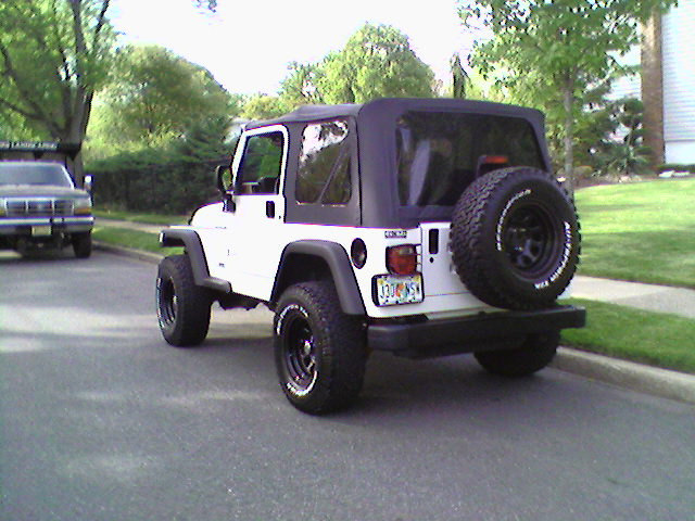

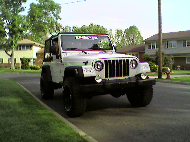

Let us know how things turn out... Included below is a picture of my 1999 TJ with the 1" body lift and 2" budget boost. Running the 32" tires, and very happy
-Rob

Hey Rob nice jeep how is the highway performance with your setup. And what size are those tires? 32 9.50?
Someone on the board was wanting to get rid of a set of Rubicon springs. They are 1" taller then stock TJ springs. I'd suggest getting those springs and getting a 2" coil spacer budget lift. Get a new set of longer shocks and you'll be able to run 33"s. I had them on my TJ for a few runs with just the 2" spacers and it only rubbed in tight turns and hard flexing. However, if you're not running 4.10's in the gears it's going to have enough power to barely be able to get out of it's own way.
Im very pleased with my highway ride. I can get her to 75-80 with no problem. I am looking at around 17ish mpg, which isnt bad...
Those are 32" x 10.5" I believe...
