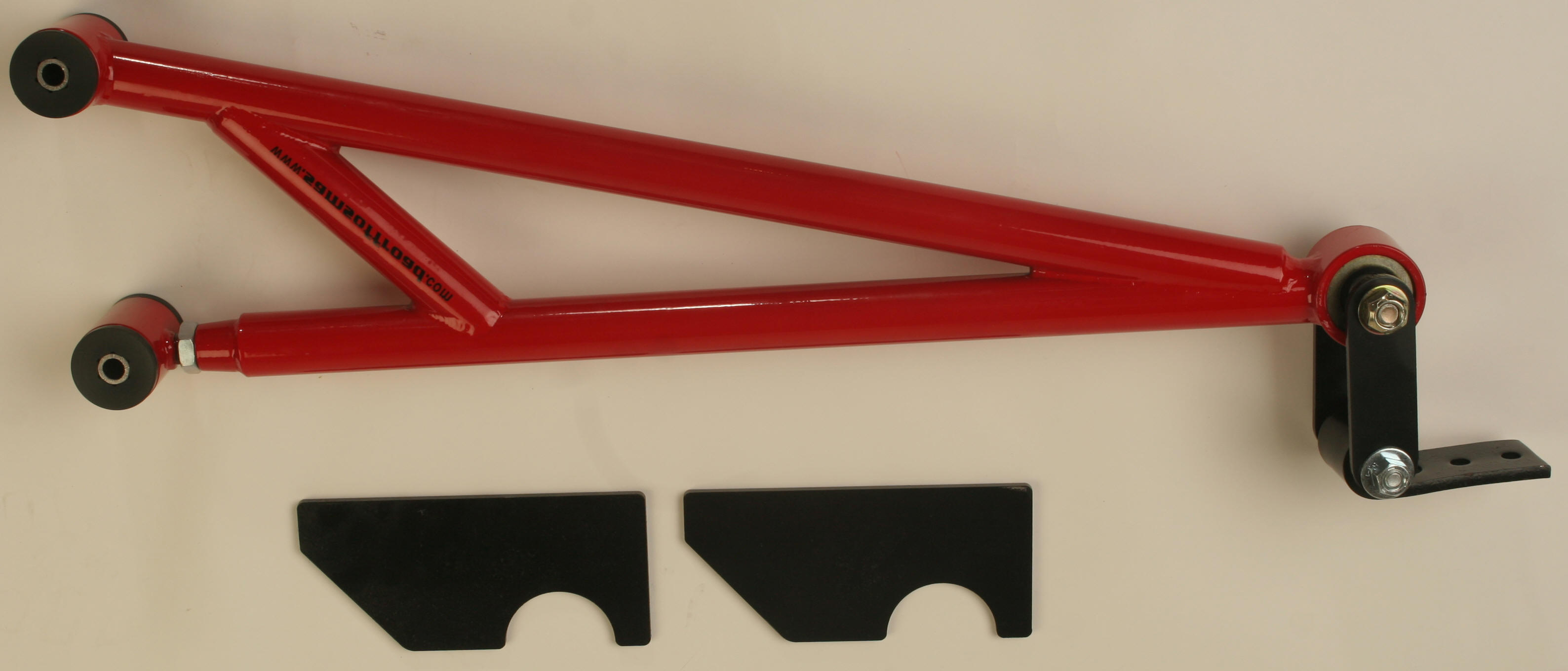

Help, I'm looking to build or buy a traction bar for my 93 YJ SOA. Looking for ideas and suggestions. Pictures are worth a thousand words.
I don't want this happening again. Happend while crawling from rock to rock. At Funny Rocks near the Naches Trail near Cliffdell, WA.

A light spring pack coupled with long 'anti-wrap' spring perches likely aggravated the problem.
Sam's Offroad makes a good unit: Sam's 4x4 Store

I have heard good things about sams track bar. I preferably would make on since the materials cost way less. I would avoid the skyjacket 5th link like the plague. I had to install one for a buddy, one of the worse designed POS I have had the pleasure to install. For the price it should have been better.
I recently looked at the Fabtech FTS94041 Jeep YJ 87-95 Rear Single Traction Bar. Anybody have any performance/install feedback on this? FTS94041 Jeep YJ 87-95 Rear Single Traction Bar FTS94041 Jeep YJ 87-95 Rear Single Traction Bar
