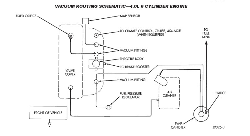

So I've been working had trying to get parts and put them on my jeep. It's been a long 2 years since my jeep has run and I'm getting antsy. I put the 4.0 in my 91 yj replacing the little 4 banger. While everything seems to be coming together nicely I keep running into little head aches. Hopefully someone here is able to help me.
1). What size are or where can I get the starter bolts? I really need the size of the one that threads into the Bell housing. I was able to accurately replace the bolt that goes into the starter.
2). Does anybody have a good diagram of the vacuum lines for the 4.0?
I'm sure I will run into more questions or issues later but any help now will be greatly appreciated and hopefully get me over the "hump"
