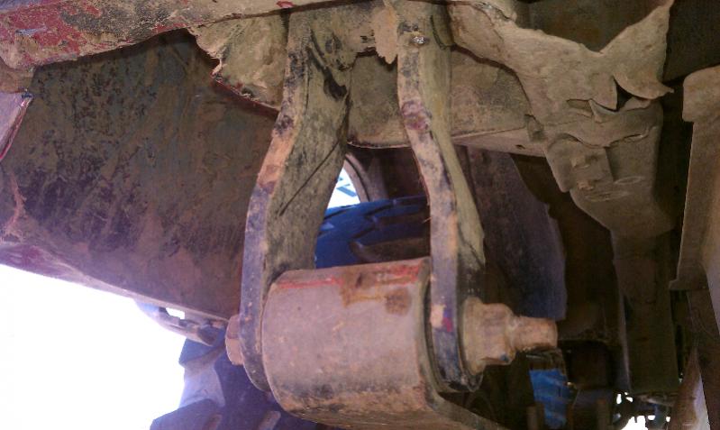

Will the dakota springs give me enough clearance to fit my 33s... Do I just cut the eyelet off the dakota springs and stack them on my main spring and discard all my old ones... I have lift shackles but not sure what size...thanx for the replies

Thats what i did im at 5.5 inches total with my shims etc. I used from a 98 dakota the later model the better it will ride.
No prob. And if you want a cheap lift block just cut the centers out of a few of your old springs and add it to the leaf pack. Stronger tgan a block as it is bolted to the springs.
