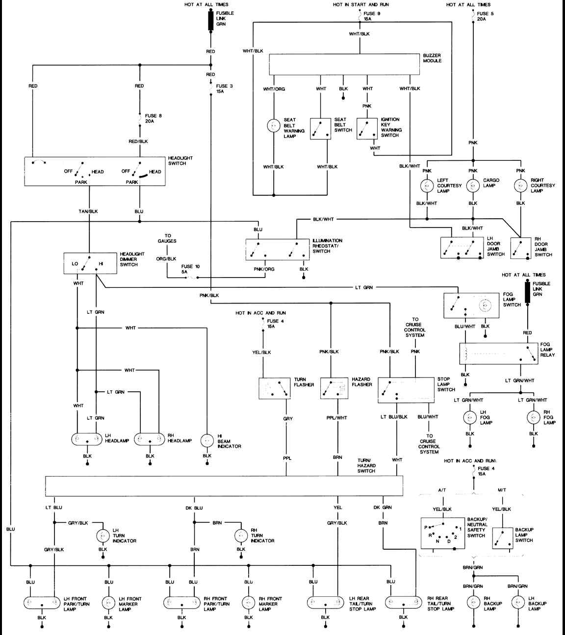

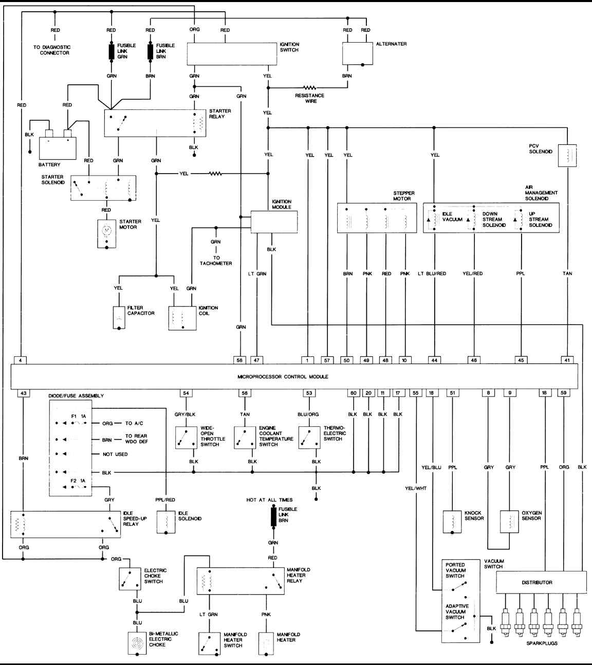

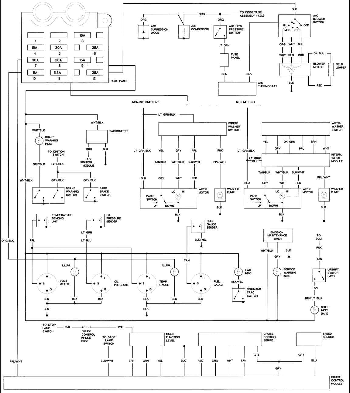

i got this off ako
Okay ii tried using this diagram. And i try new headlight switch. I put new battery in just failed. But the problem is still there the headlights are staying no matter unless i pulled the fuse off. and still there is draw on the battery. like i put my te
I put new switch,new batter. yet problem is still there the headlights are staying also try to unplug 2 plugs under steering column. no diference. And there is paracytic draw when put mny negative off and out the test light negative circuit in series my test light is still illuminating even with the lights fuse off. with light fuse on it illuminates brighter i took all fuses off still there is draw in the system. whats that all about. Any body ever face this issues.
