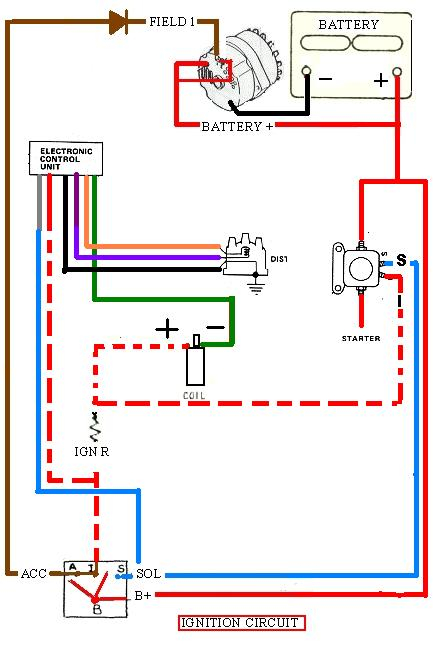

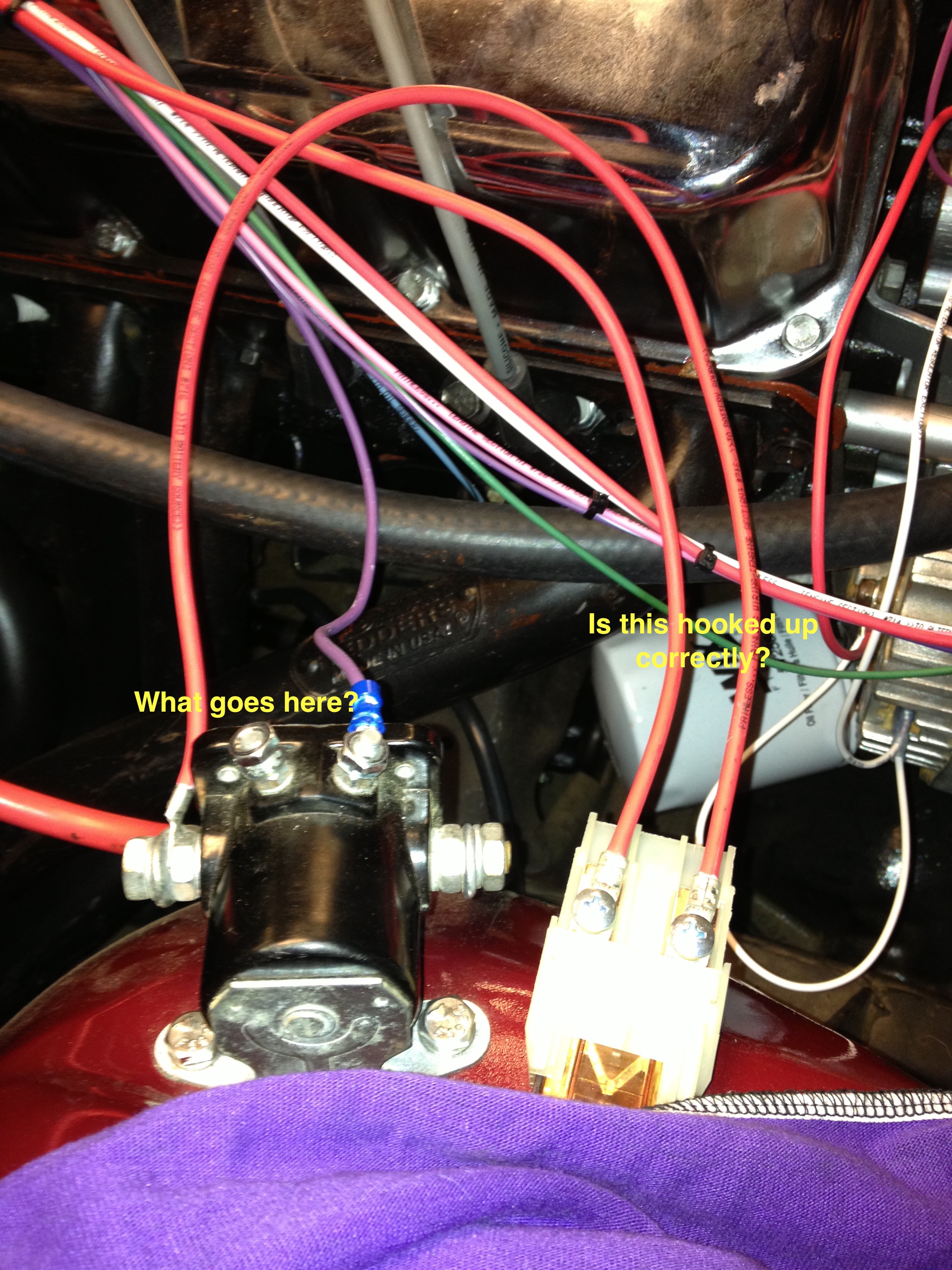

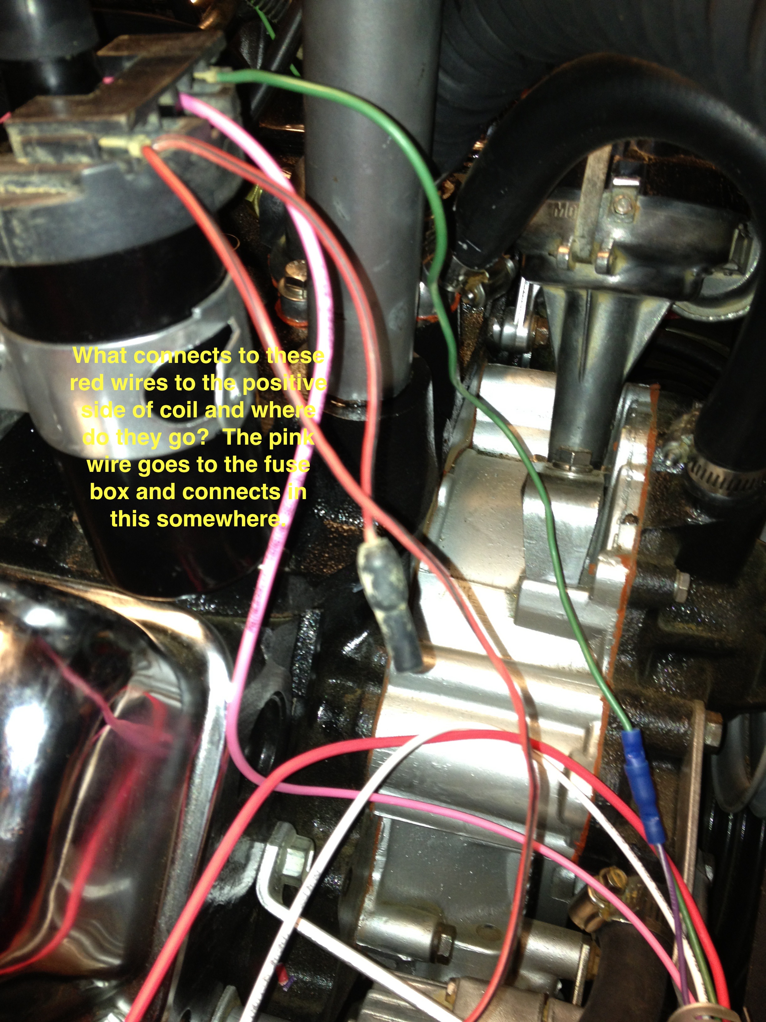

I am trying to install a Painless wiring harness in my 79 CJ-7. It has a 304 V8 and I do not understand the connections from the electronic ignition to the coil to the solenoid. The diagram in the instructions mentions wires that are not present in the harness. I am not sure what the resistor wire looks like so I'm not sure I have one. I took a lot of connections and wires off the old harness because the connectors for the ignition were not in the new one. I have included some pics of things and asked some more questions. Also, there is not a connection in the harness for the brake proportioning valve or for the transmission wire. How would I go about getting them connected? They may have connections already built in, I just don't know a lot about wiring so I don't know where they go. I included the pic from the instructions that I used. As far as I can tell I have a Motorcraft Electronic Ignition System. At least mine looks the most like that picture in the instructions. Ha. Thanks for the help, this is what is keeping me from trying to crank it.

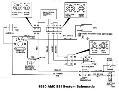

I regret I cannot do a righteous job of mapping out the connections at the moment , but I have a wiring diagram of a 1980 CJ and will try to help out . I need time and hope to do it soon . So far , the pic of the ignition resister is wired wrong. The side terminals of the starter solenoid (large) are for the battery cables from positive side of battery only , battery positive to one large post and cable to starter from other large post.there must be a power wire from large post on battery positive side of starter solenoid to ignition switch power terminal to supply power for all power circuits for fuse box as well . Negative battery cable to engine block , S terminal to starter terminal on ignition switch via the clutch start switch or neutral safety switch if automatic but through ignition module to S terminal on starter solenoid , must research that first. I terminal to ignition terminal on ignition switch also through ignition module , must research as well . The ignition resister is wired between ignition coil positive and starter solenoid I terminal but have to see how ignition module is wired with this . The pic of the two wires from ign. module ; lt. Blue to neutral safety or clutch start switch to solenoid terminal on ignition switch , this will crank starter. The red wire will go to ignition switch ignition terminal through I terminal on starter solenoid to ignition coil positive. I cannot correctly address color codes from painless wiring on horseshoe clip to ign. Coil since there is a red /black wire(s) and diagram shows red/white wire. This is all rough , will have to look closer to get correct routing of each wire. Basically , S terminal on ignition switch will go (roundabout) to S terminal on starter solenoid and I terminal on ignition switch will go (roundabout) to I terminal on starter solenoid to crank starter. Again , I need to take best look at diagram and repost. Will do so as soon as I can . Now that i have totally confused you , i must help to get this right for you to understand whatve posted thus far. Thank you for your post . Greg

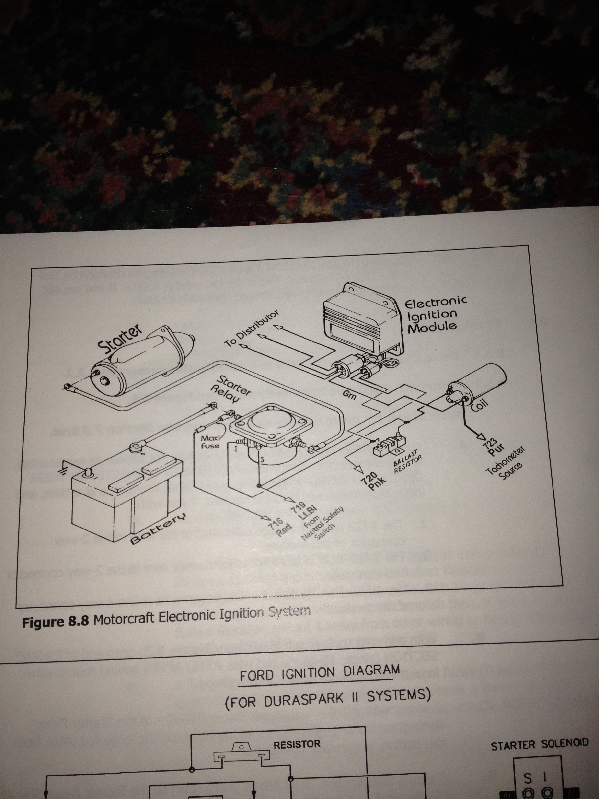

These pictures may help , at least they include the ford dura spark ignition module to clarify connections . Hope this helps until I can study and map out connection by connection.
Im a bit confused!!! Your diagram shows a electronic ignition with control module, it also shows a ballist resister???? As far as I know, ballists are used with points ignitions, not electronic. The diagrams greg posted don't show a ballist, you also mentioned a resistor wire and again a resistor wire was on old points ignitions that used ballist. Are you sure you are using the right diagram for 79?? Ive had a couple 79,s and they did not have ballist resistors or resistor wires. I switched one of them to points ignition and had to install those items. A resistor wire will have a cloth or canvas looking covering. The ballist is really throwing me off here, I don't know why they are showing that in the same pic as the other components for a electronic ignition. I would call painless and ask, or someone please educate me on this. The ballist is used to drop volts from the ignition to the points, because the points cant receive a full 12v all the time and the ballist drops those volts down to around 9v so your points don't burn up..
69jeepcj, I'm just using the diagram in the instructions, that's how it shows to wire this up. I hasn't made sense to me because all the wires are not there. greg92jeepxj, where is the neutral safety switch? The red/blk wire on the coil connector was already there. I cut that from the old harness to re-use with this new one. There is a pink wire that the instructions say to connect to "one end of the existing Resistive Wire. . . Connect the other end of the resistive wire to the Ignition Coil POSITIVE (+) terminal with 14-gauge wire." This confuses me because the diagram shows a wire from the +positive side of coil to I terminal on solenoid, then the pink wire #720 comes of this, which goes to the fuse box. Don't get it.
greg92jeepxj, the big red wire that goes to the "Maxi-fuse" and connects to the positive battery post on the solenoid comes from the fuse box. This would provide power to the fuse box and the way it is connected is how the diagram shows it in the manual. So, should I connect the pink #720 wire to one of the red/blk wires of the +positive coil and connect the other red/blk wire from +positive coil to the I terminal? Should I splice the red wire from the ignition module to the red wire coming out of the fuse box?
Please hold that thought , your right , power is sent to fuse box for power distribution throughout jeep from a connection at large stud on solenoid from battery positive. I'm sorry I have to go back to work now , but I will look at this tonight to lay out jeeps way to concur with brother 69jeepcj and then we can question painless wiring .
The following is from a 1980 CJ wiring diagram reprint from Willys overland :
Photo #1:
green wire from ign. Coil negative. to 4 way ign. module plug green. Pink wire to fuse box ? Or firewall bulk connector ? For tach ? Red wires from ign. coil positive - wire w/black plug is "capacitor jumper" is open. Red wire from ign. coil positive splices to starter relay " I " terminal and ign. module red resistance wire from two way plug w/blue wire to terminal #56 in firewall bulkhead connector.
Photo #2 :
is purple wire from firewall bulkhead connector terminal#34 starter solenoid "s" terminal w/ lt. blue wire from ign. module ? Is that terminal block of resistance value ? I do not show this on my wiring diagram. Unfortunately I do not have power supply wire to fuse box on my wiring diagram.
photo #3
Lt. Blue wire to firewall bulkhead connector terminal #34 w/"S" terminal wire from starter to solenoid . Red w/white wire to firewall bulkhead connector terminal #56 w/ red resistance wire from ign. coil positive and starter solenoid "I" terminal . There is a splice from ign. coil positive to solenoid " I " wire and resistor wire to firewall bulkhead which splices to red wire from ign. module.
please check with painless wiring before making these connections
Thanks guys for all your help. I found that there was a resistive wire on the old harness and I connected that into the ignition module like the diagram from Painless showed. I tried to crank the Jeep yesterday. I think the timing is still off and it is not getting gas but the wiring seems to be correct. It tried to turn over but didn't seem to be getting gas. I will double check timing today and work on fuel pump. Thanks again for all your help.
