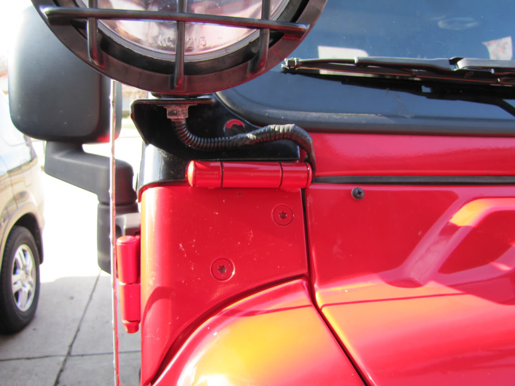

2x on the advice to use long range lights and consider wiring. Here is how I set mine up.
IIRC, I originally installed the cables going in through the sides, and that caused leaks. Then I ended up going like you (on the bottom side of the seal), and that stopped the leaks... Or was it backwards? I dont really remember... That was about 10 years ago!
Mine are into the cowl across to the driver side then down to the grommet near the brake pedal.
They do not go under the windshield.
I do not recommend disturbing the windshield seal. Like you stated.
