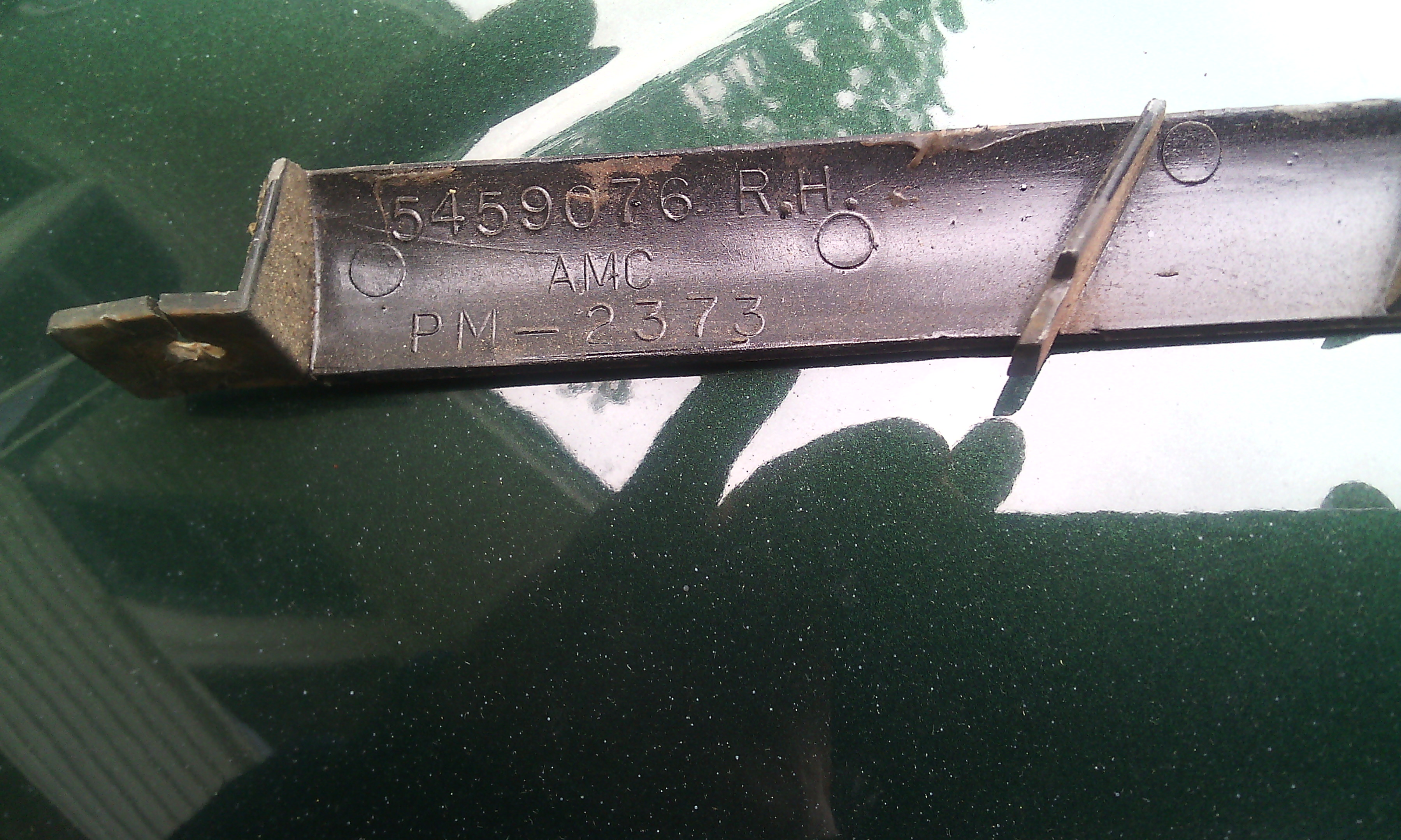

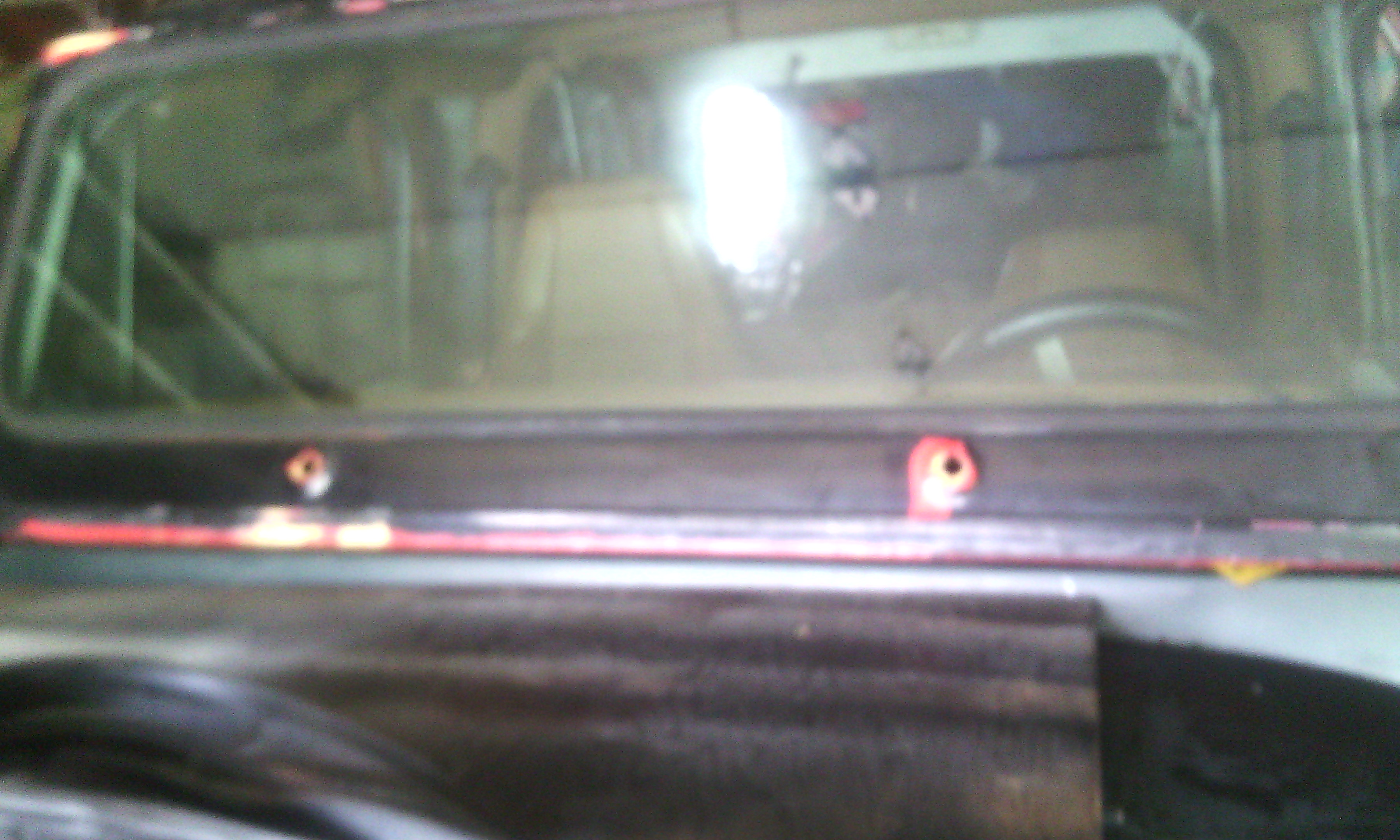

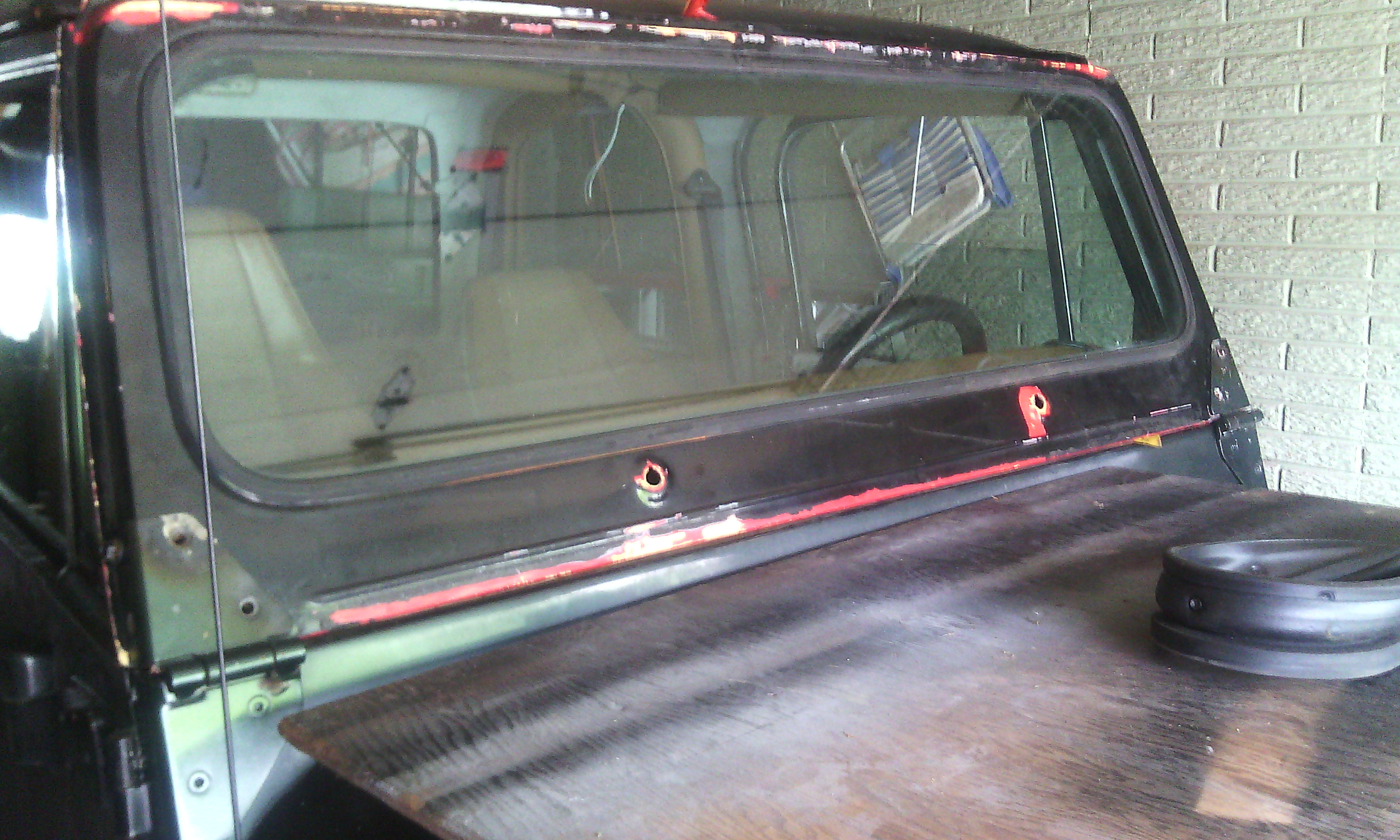

Purchased a fiberglass windshield Frame with glass for my 94 YJ. The hinges and frame line up but the bracket to dash needs to be modded. Could anyone ID this frame from the pics.

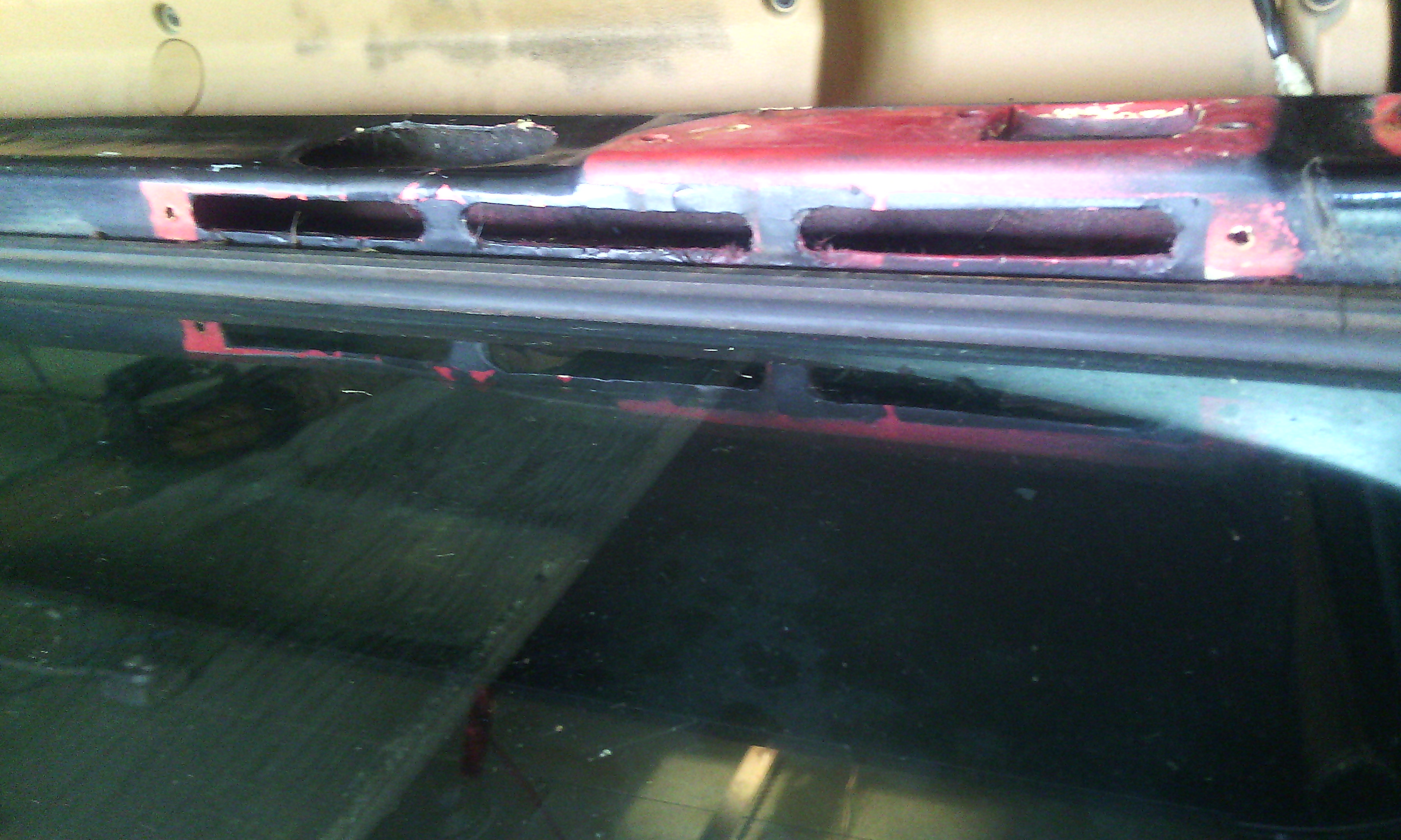

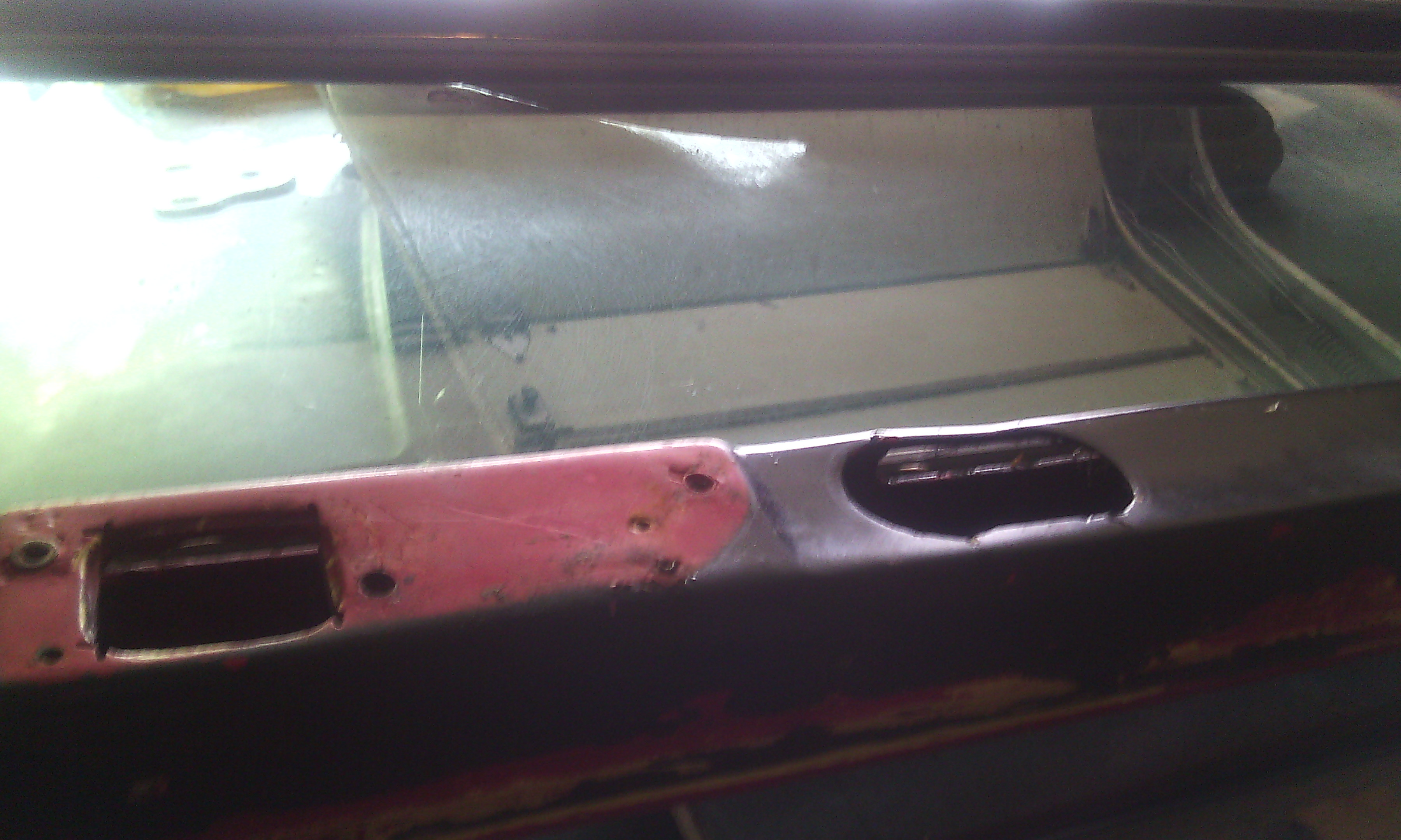

The frame has the defroster vents in the frame itself instead of coming out the dash.
Will I have any trouble using this frame besides having to use different wiper assembly ? Does the numbers on the vent indicate 1973 or 1976?
Thanks Stan

cj windshield frame. You can use it as I understand but the frame has no holes for the wranglers bars that attach to the upper corner of the frame. If you have a hard top you may have to play with it a bit where the top fits over the lip of the frame.
